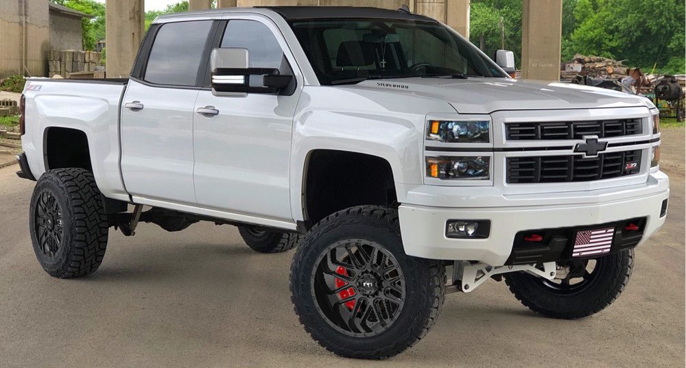

Hey everyone,
I've got a 2015 Silverado 1500 5.3 with the 6 speed and factory 3.42 gears.
I'm looking into lift kits and have decided I want to run either a BDS 6" strut replacement kit, BDS 6" Coil over kit, or the 8" Coil over kit. I've found the main differences to be
Wheel and Tire Size
Size of Diff drop
Garage Clearance
I'm looking at running 35x12.5r20 with a 20x10 -24 if I do one of the 6" kits or 35x13.5r20 with 20x12 -44 with the 8" kit. Either setup would be re-geared to 4.11's
From my research, the 6" kits don't drop the diff the full 6", its more like a 4" with a leveling kit where the 8" kit is a full 8" drop.
Correct me if I'm wrong.
I've seen other members say their 6" kits with 35's were at roughly 81" tall, which puts a 8" kit up to 83" tall. Ive noticed most garage door openings are only 82" tall on a 7ft door. So maybe with some modifications could be made to 84" tall?
Just looking for opinions on what you guys would do.
Included a photoshop of my end goal
I never really understood the purpose of the 8" kit when you can run the same size tire on the 6" and fit in more places.   I have the 6" coiI over kit on 35x12.5s and love it.

Some guys like to be up higher. Like myself.
Sometimes I wish I would have went with the Bulletproof 12" lift instead of the 10.5" lift I have.
Then I could run Fawtys.🤣

Same here bro, maybe on my next truck I’ll do that but wife wants a yukon so idk yet.
The higher the lift they better it looks 😂 sorry she’s dirty AF right now 9” McGaughy lift but gonna add the 2” leveling kit to front and 1.5” rear shackle to lift the back to get it alil higher wish I would of just did the 12”

Sorry, the pics became progressively more upside down, so I thought, Aus, maybe? 🤪

It’s really just a matter of trimming and angles. If I decide on the 12 wides I don’t want to cut the crap out of the truck. And the 8” kit drops the diff closer to factory angles.
