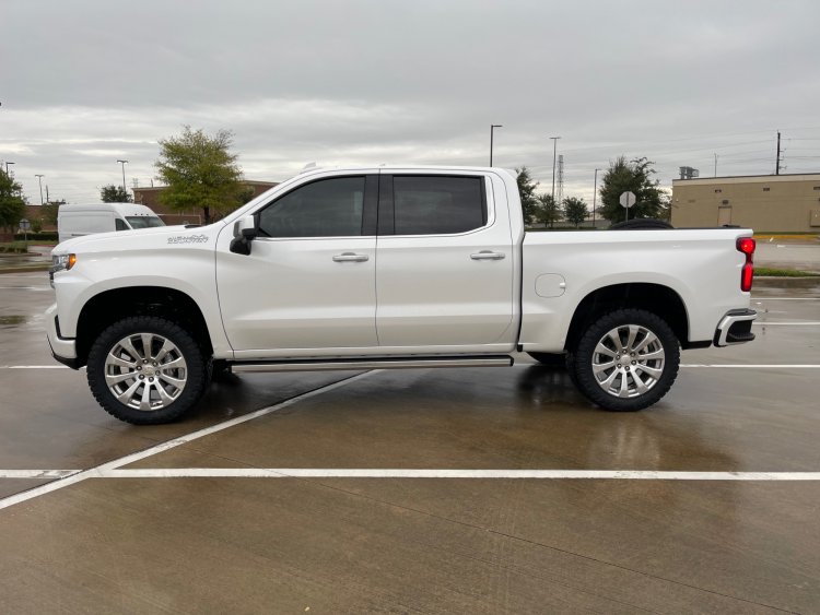

I had it installed today on my 2021 High Country after reading positive reviews.  I ordered it from rough country and had it installed at a local shop, not through an off road shop that was pushing it and they had positive things to say about rough country products they have used in the past despite the usual hate they receive.

Looks good!  Did you go with the strut assemblies or the spacers?
The ride is great.  We took a trip in it this weekend and my wife commented on how smooth the truck is.  My last truck, a 2019 F150 4x4, my 12 year old would get car sick in always, he was just fine this weekend.  If you chose to do this, you’ll be happy with it!

Looks really nice brother. Just curious, what size are those tires? I just bought the same kit but with the lifted struts. My Silverado Custom came with 275/60R20 and I just want to know how it would look like when the kit is installed. Planning on keeping those tires for a couple of months until I can get Nittos or Mickey.
