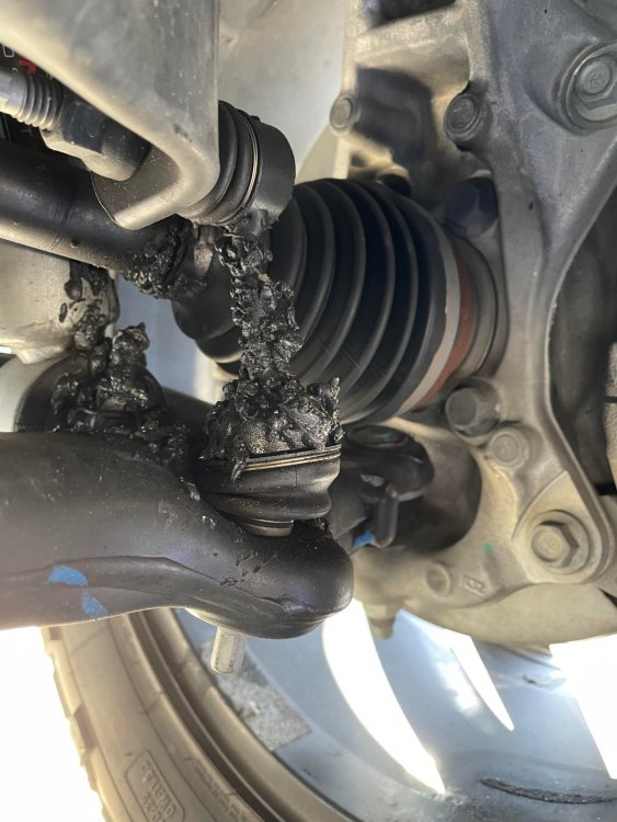

I have had this lift installed since September 2021 and now I have my sway bar rubbing on my CV shafts while I drive and the two bottom strut bolts are rubbing on the CV boot causing the grease to leak out.  I have an appointment this Friday to have it corrected and will keep you all updated.  I can correct the bolt length but my sway bar rubbing the CV shaft concerns me.
When I called Rough Country they pretty much said there wasn't anything they can do and to take it to the shop who installed it.
Rob, I'm only 2WD, so i didn't encounter that issue when installing a week ago, but i did notice in RC reviews that someone mentioned the same thing. I reached out to rough country and had them send me the sway bar drop kit just incase. They said it was not needed, but i told them it was in the instructions (see attached on page 8 ) and another diesel model had issues with it, so they sent it free of charge. I feel like it was a last minute edit as the picture was drawn instead of a real picture, and hope this may help your issue.

I could try to get you a picture later today or tomorrow morning if you're interested. It's basically 2 metal, roughly 2" thick spacers, that mount to the frame to push out the sway bar..... found a similar link. would be for the T1

Did your kit come with the sway bar drop?  Its not shown in the kit when you look it up online.  I noticed it in the installation insturctions and called them.  They said the new kits are coming with it - to help with allignment issues.  Anyway you can order the sway bar drop kit for about $40 from them.
