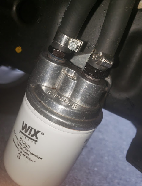

I installed a remote spin-on transmission filter a couple years ago. Whenever I want to change my trans fluid, I just remove the spin-on filter, start the truck, and drain a gallon of Dex 6 from the filter mount. Works great, super easy.
However, I was toying with the idea (had I not installed the remote filter setup) I would splice into the same location of the rubber transmission hose, below the harmonic balancer, and install a 3 way valve. Would make draining the fluid super quick and easy. Thoughts?
This is the remote filter setup where I drain my fluid, usually once a year when I change the filter.
Coming up on almost 2 years and 22,000 miles since installation. On my third Wix filter. Everything has been flawless so far.
