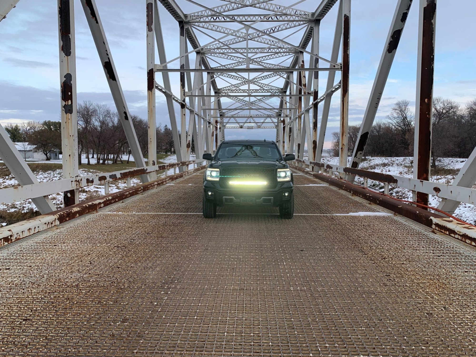

Got any pics?
See profile pic.  Light has a cover on it, but you can see it.  Pic was taken before I added a-pillar and grill lights.
