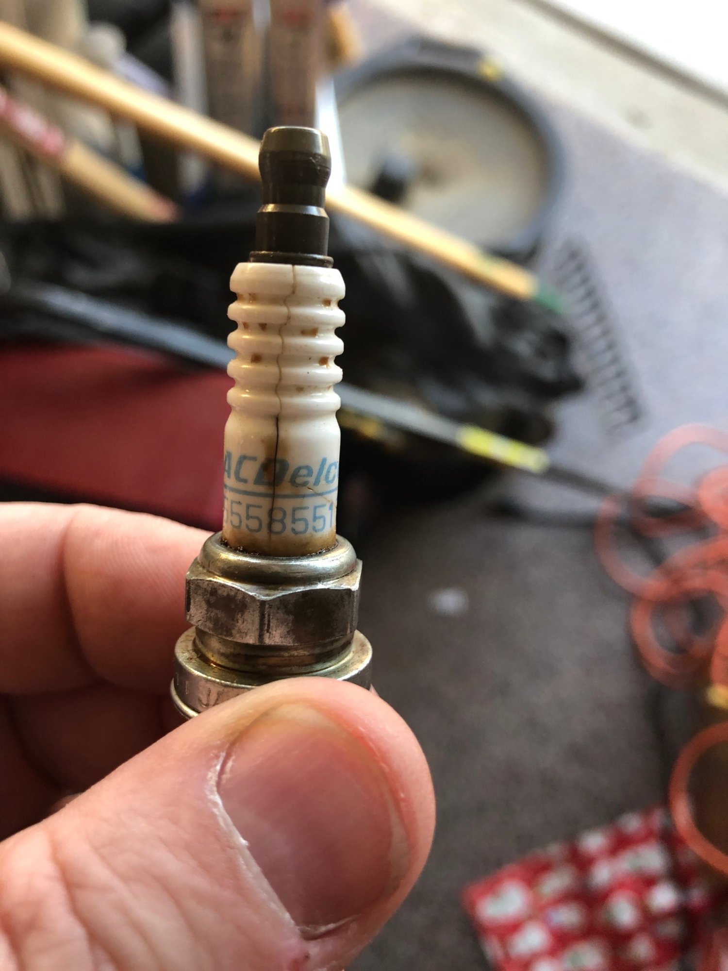

Multiple Cylinder Misfire. Will replacing spark plugs solve the issue .
My daughter's '14 Cruze did the same thing at 135K miles.  Replacing the spark plugs fixed it, especially since one of them was cracked in two places, was shorting out to the block.
