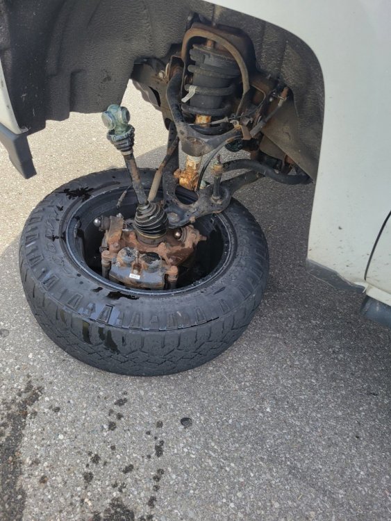

I bought a new  2018 Silverado with a dealer-installed  69 3414 ready lift  69 3414. The truck was taken to the dealer for regular maintenance and I did mention the noise but was told it was nothing even though the tech noticed wear on the tires, they neglected to inspect, and I don't think they know how or what to do. Left front tire fell off last week with just over 60k and of course dealer states no warranty coverage as it was not maintained. I will fight it, any help for my plea appreciated.
