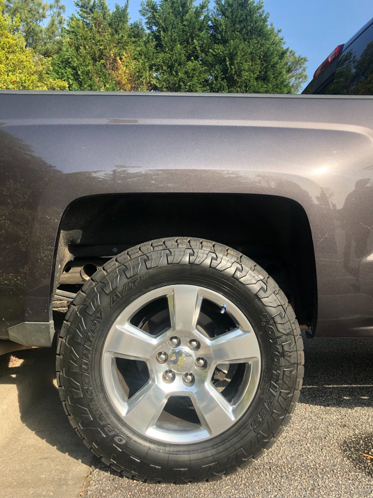

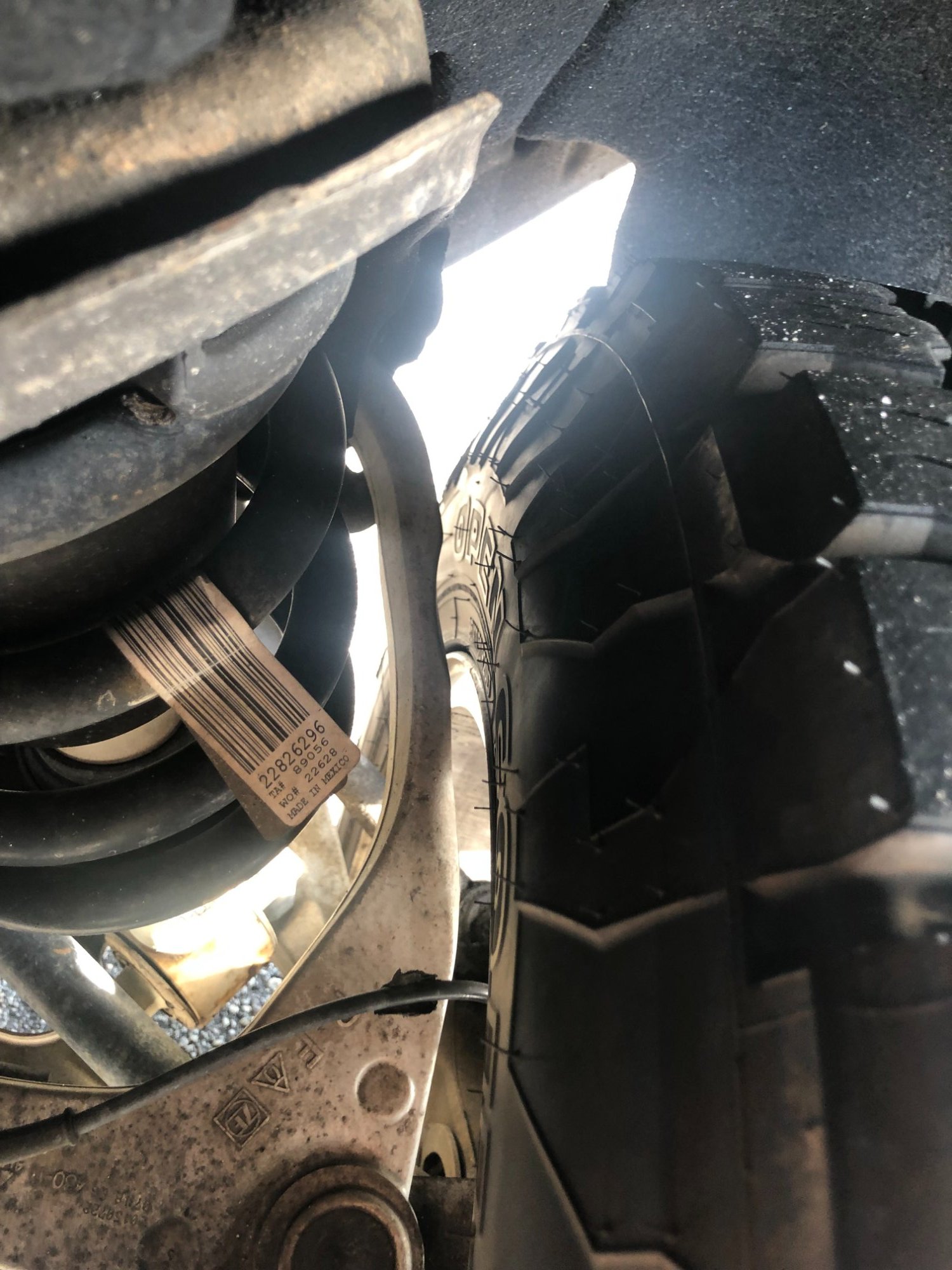

FWIW - just got a set of Toyo AT3 35x11.5r20's on a 2015 Chevy Silverado with just a 2.5 RC Leveling kit and no rubbing at full lock in either direction.  Some minor liner trimming was done as a precaution when installed but still think it clears regardless of that.  A modern day miracle.
