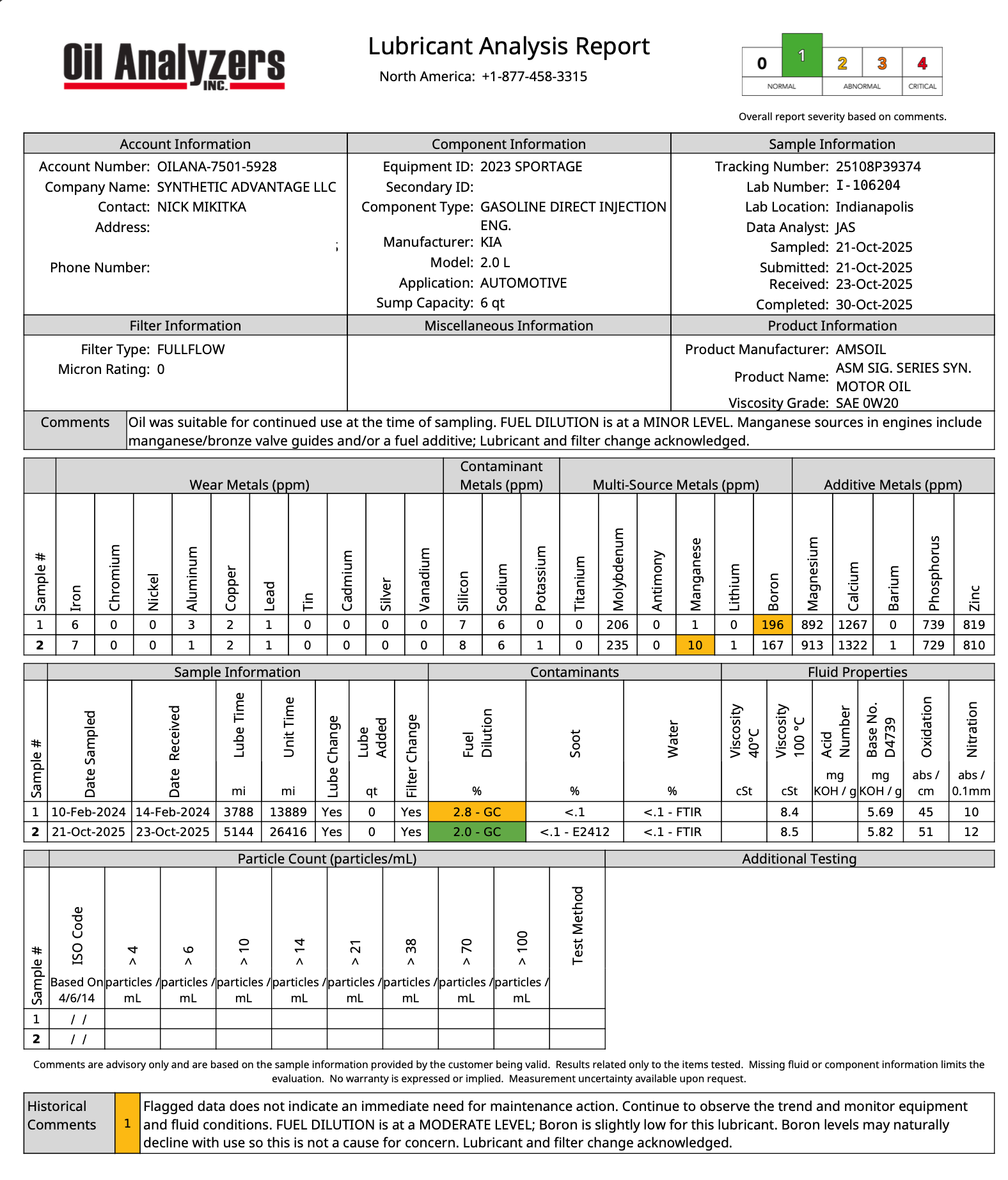

Here is the latest UOA on my daughters 2023 Kia Sportage.
Kia oil filter.
Kia air filter with 5k miles on it.
AMSOIL Signature Series 0w-20, 6qts 8oz.
Edited by Black02Silverado

Raven at 35K...Final answer
 I would not have know this detail if I had not also run a UAO on Pepper from the same batch (case). Note the change in TBN chemistry? Now look at the oxidation? In Pepper, which shows no fuels, that value is 62. At minimum a 30 point spread assuming no elevation from base in Peppers sample which is silly to believe.
When this sample was first run the attending paperwork which is attached to the outside of the pouch went MIA during mailing so the sample was run anyway but the Protocol is to run it as a Diesel motor oil sample. This has an impact on how the fuels is reported.
A gasoline motor whose 100 C viscosity has dropped less than 1 cSt from the SAE grade mid point is reported as a fuels 'Estimate' of <1% and not actually run. For a diesel motor that threshold for actually running the GC is still 1 cSt but the 'Estimate" report is <2% and thus the original sample was so labeled and why not flagged!
Elevated iron and aluminum from the trend along with this 2% estimate had me asking questions and the first run at it got the response of explaining the protocol. The tech then went the next step and actually ran the GC which in deed and fact was higher than 2%....just...but higher.
Interestingly enough the viscosity trending in accompaniment with my detailed fuel logs show the point the injectors took a hike. During the miles accumulated to generate test #6 or two samples after the fact.
Doing a Red Line SI-1 injector service currently. I will request the GC be run on the next sample regardless of viscosity result. If the service works, fine, I leaned something. Several somethings. If not then the injectors get replaced.
This is a MPFI motor, not GDI and this motor from my first tank has seen only Shell V Power Nitro + fuel which has a boatload of detergents in it all ready. 3X the levels of Top Tier Fuel. (So the adverts say).
I'm still in conversations with OA and getting positive movement. @Black02Silverado supplied the contacts and took the initial lead. I'm very happy with Nick and the lab at this point and now more educated about the labs protocols.
I will set my own internal markers for viscosity reduction and improved fuel system maintenance. And tickled pink I chose to use the Mirage "Home Market' oil "weight' grade and not the North America 0W20 SAE SP, ILSAC GF-6A spec oil.
