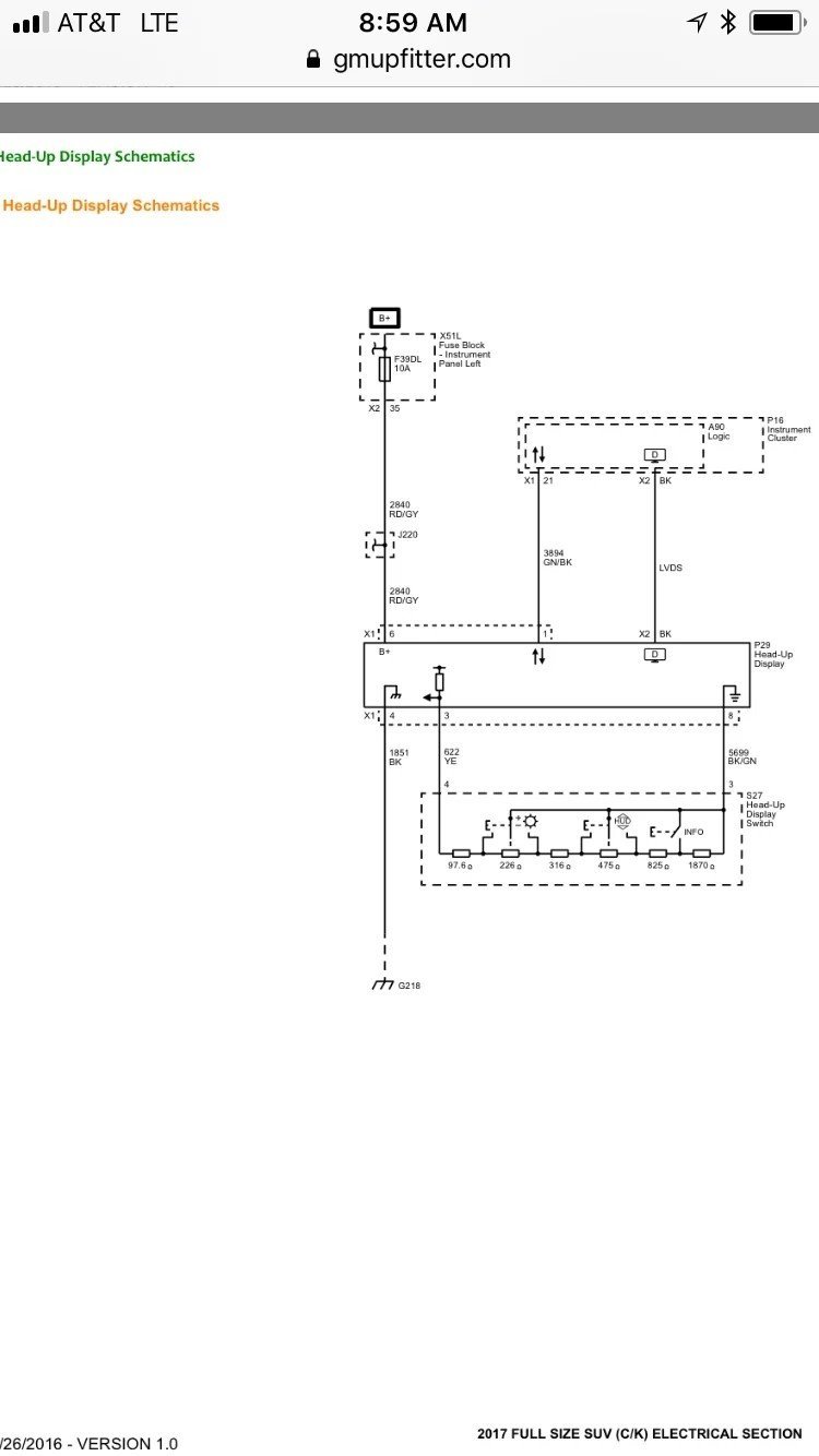

I have a Silverado 2021 time to install the Heads up display feature
I installed these parts
Mount Bracket: 23407367
Driver Information Display Switch: 84456360
Instrument Cluster: 84804721
Instrument Panel: 84553050
Cluster Visitor: 84054788
Head-up Display: 84395830
Reinforced Beam Deflector: 23387335
Outlet Duct: 23391609
Windshield: 84398043
WAM VIN Programmed
Phil's custom harness
-2014 - 2018 Silverado / Sierra - HUD Retrofit Harness - Harness Dr. DIY Done Right
but not working

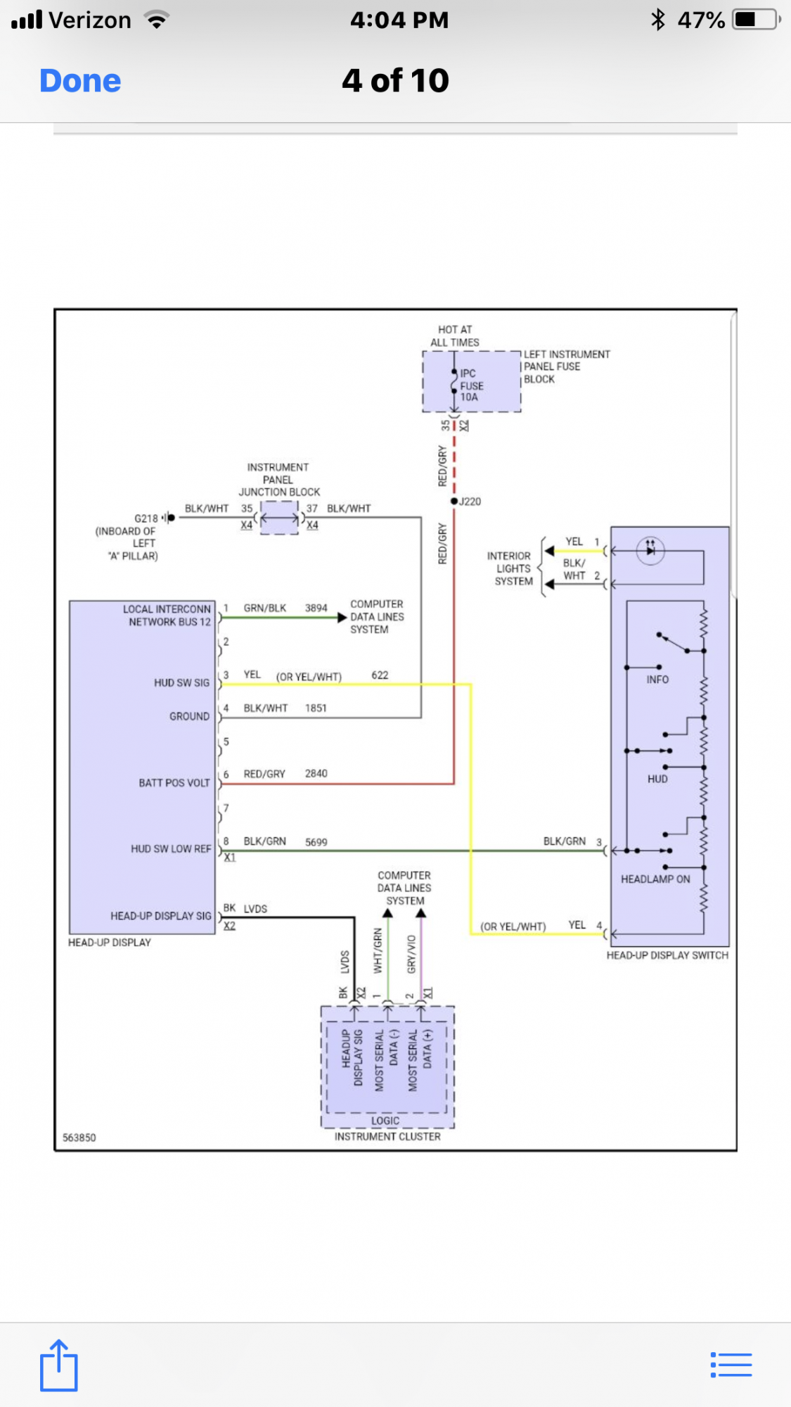

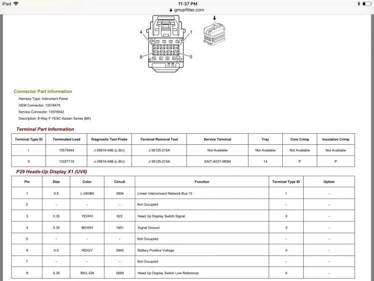

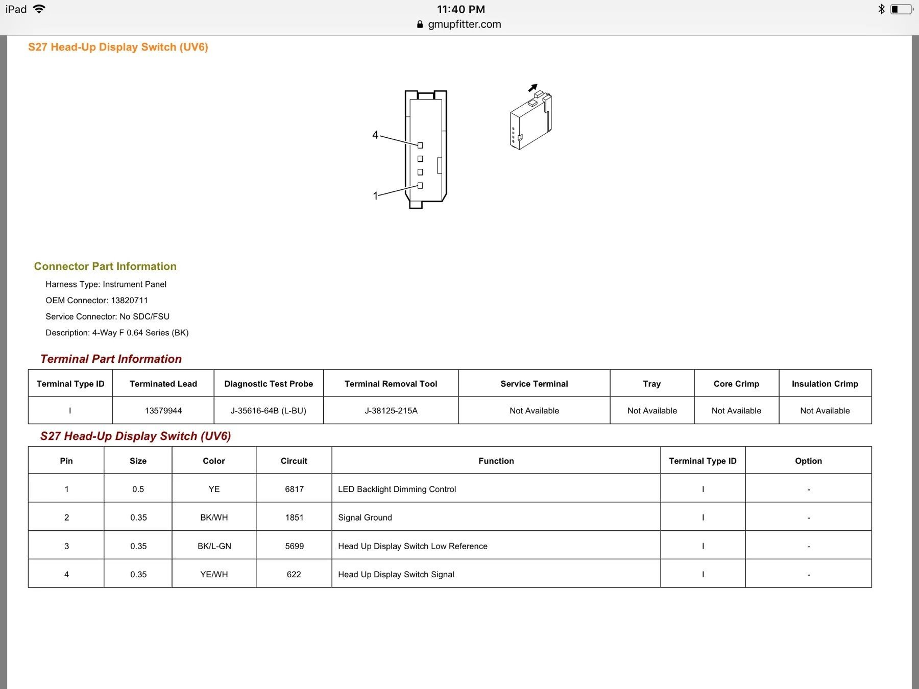

I have a question about
Regarding the wire that goes to the Clusters
 the wire into the block connector Cluster PIN 21
Is the 2018 model the same for 2021
and about
yellow wire to x51l fuse
x2 - pin 3
LED Backlight Dimming Control
red wire x51l fuse
x2 - pin 35
Battery Postitive Voltage
This is for the 2018 model
What about the 2021 model
May I know where I can install these wires?
thanks

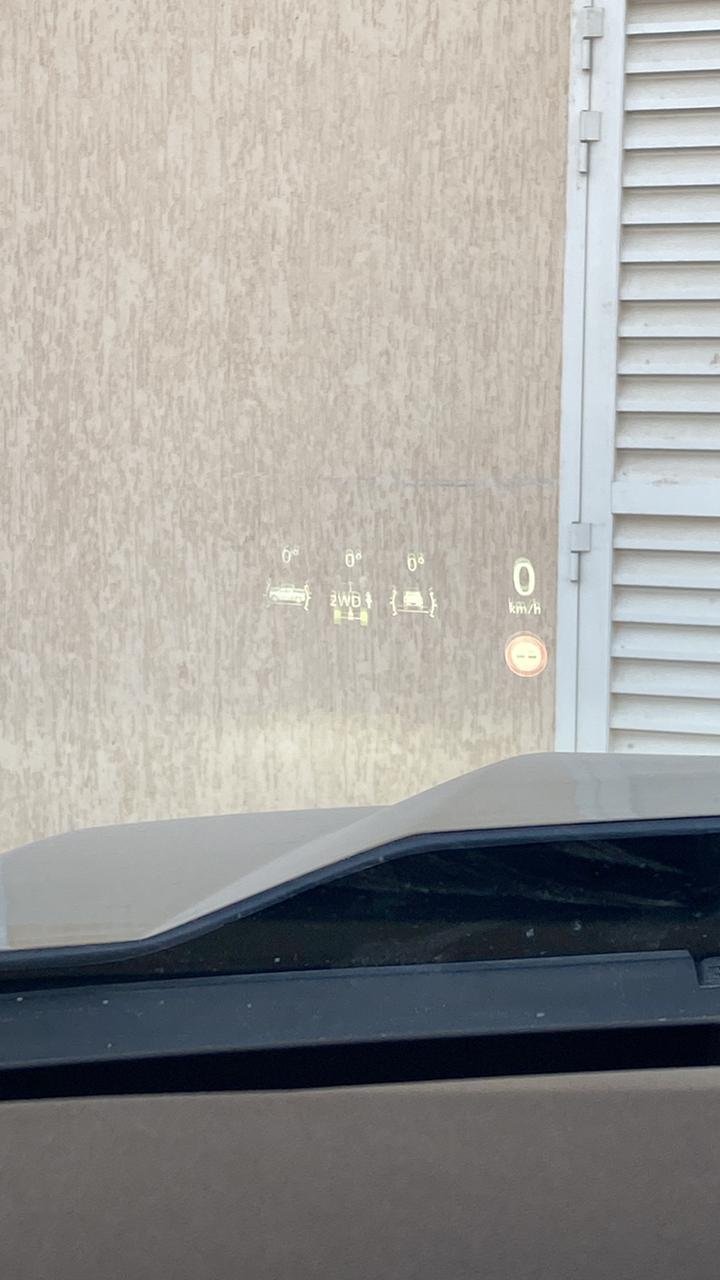

Thanks for your time, information and help
  Everything is fine and the HUD project was successfully run
2021 Chevrolet Silverado 1500
