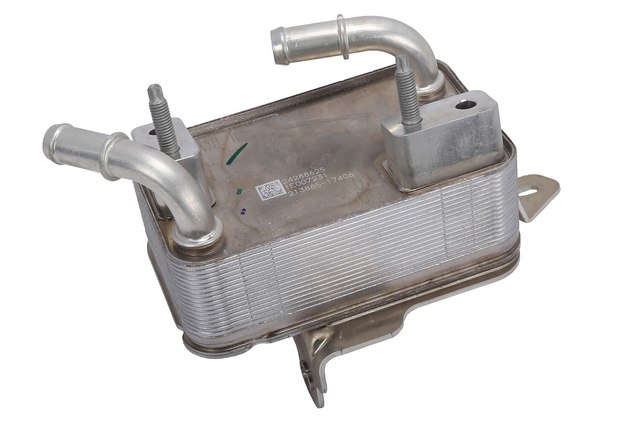

Read here:  Overfilled Engine Coolant Reservoir with Discolored Coolant – TechLink (gm-techlink.com)
Its a possible issue on 2.7T and 3.0 Duramax.  Internal leak of the transmission oil cooler.  Trucks affected are produced from 3/1/2021 to 2/27/2022.
The 2.7T specifically uses just an oil to water (and oil to air) cooler block for the transmission.  Its mounted on the left side.  The transmission has no flow to the radiator like the V8s do, so its just too this cooler.   Pic of the 2.7 cooler below:
2019-2021 GM Automatic Transmission Fluid Cooling Exchanger 24288625 |  GMPartsDirect.com

My truck was built 05/22 so I guess i
 safe . I’ve seen that exchanger while serving my Trailboss, interesting they used one instead of just running it straight through the radiator, I mean it’s still using the radiator fluid to heat/cool the tranny. It must be part of the new upgraded cooling package GM talks about. It’s supposedly made to warm everything quicker and keep it at optimum temps to get better efficiency.
should be a simple fix for you at least, I hope it works out for you.
