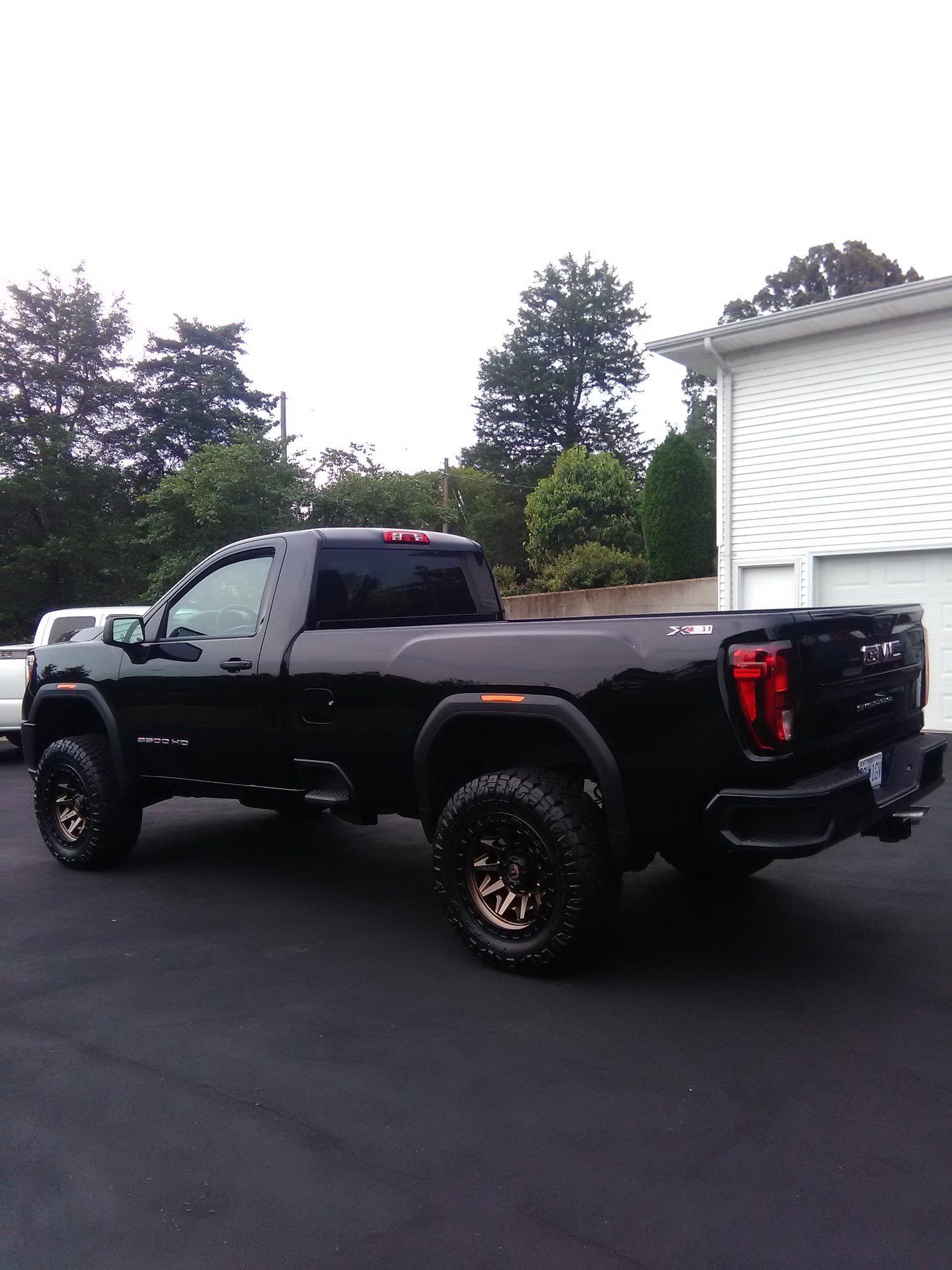

3 in blocks are too much on these trucks, unless you need to fit 37s/38s . at witch point your doing a full fledged lift kit, not just a cognito 3in level w-fox shocks and 1.0 to 1.5 in blocks. Here's mine with a cognitive front + 1in rear blocks for reference. If you need more rake just choose wisely like a 1.5 or 2 in. Or you'll get to much rear and that's worse for basically everything..... This is with a 35/12.5-20 -18 bs.
