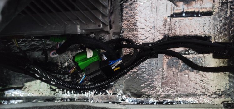

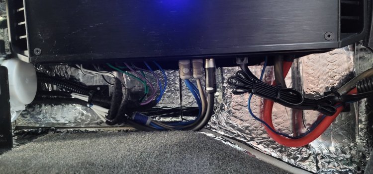

Not sure if you already bought it and installed, but I have the PAC AmpPro (AP4-GM61)  installed and it works great. I bought this, PAC APH-GM02 AmpPro to T into the BOSE harness without splicing it up and ran the output to my amp.
