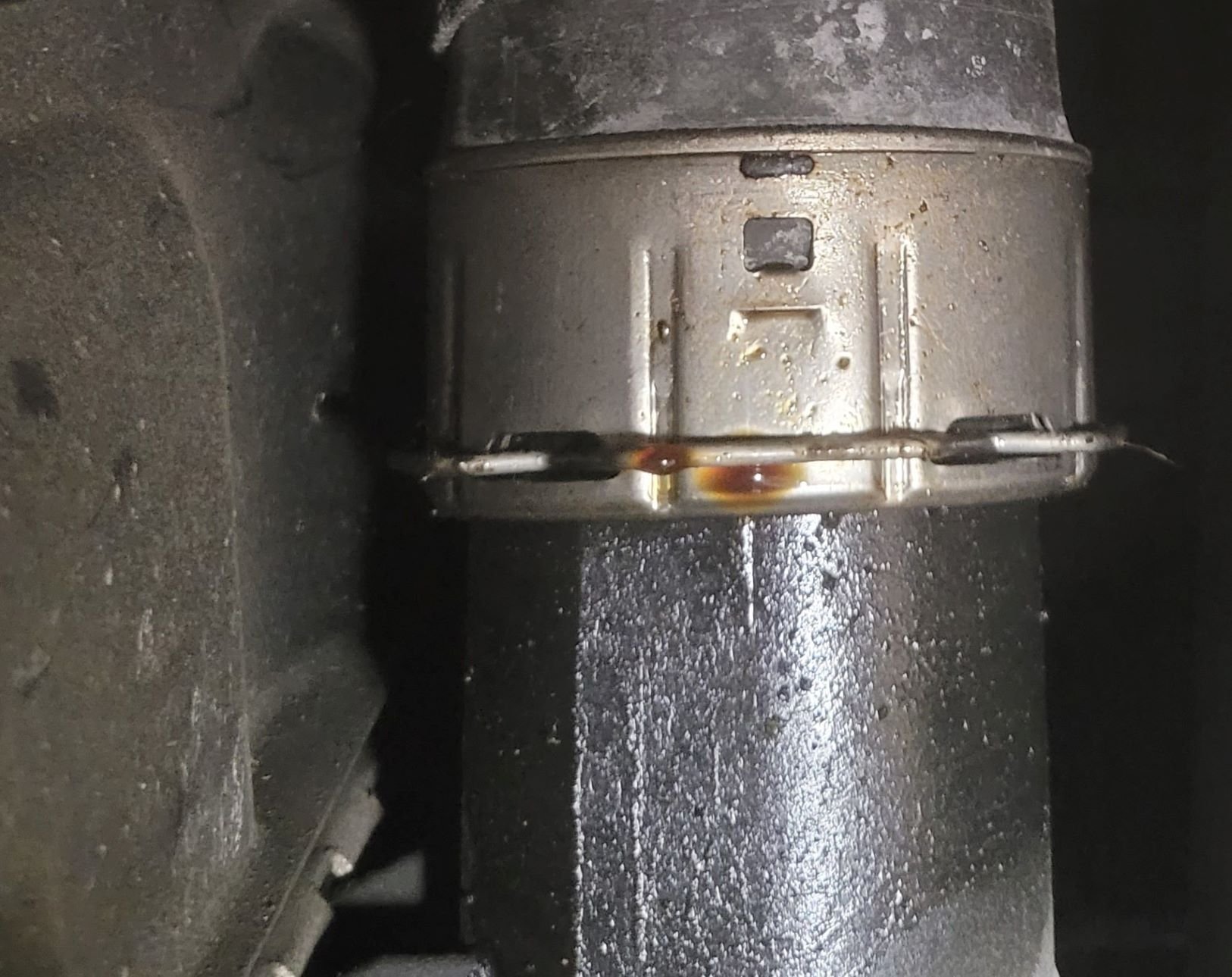

silveradosid Posted January 22, 2023 Share Posted January 22, 2023 today while i was doing an oil change i decided to take the plastic covers off, looking at the hose from the turbo to the cooler there is oil leaking out of the hose connection. do you think this is a problem and would it be covered by the power train warranty Quote Link to comment Share on other sites More sharing options...

Bmcsik20 Posted March 12, 2023 Share Posted March 12, 2023 I have a 2020 2.7 silverado and I'm having the same issues with oil in the turbo inlet and intercooler piping . My intercooler pipe looks just like yours in the picture you posted. I currently have 56,000 miles on my truck. Have you gotten any answers yet on the cause? I'm currently looking into installing a catch can. Quote Link to comment Share on other sites More sharing options...
silveradosid Posted March 12, 2023 Author Share Posted March 12, 2023 dealer does not have any loaners right now and we keep getting snow storms so i have not taken it in yet. a catch can wont help this, it is a seal in the turbo that is leaking oil. make sure your air filter is clean Quote Link to comment Share on other sites More sharing options...
Bmcsik20 Posted March 12, 2023 Share Posted March 12, 2023 Thank you for reply. I was thinking it might be a pcv issue. The dirty side of the pcv system feeds from the back of the engine to the turbo inlet. Makes more sense the turbo could be the issue as these engines have a built in air/oil seperator on the back of the engine. I'll try and get mine to the dealer . Quote Link to comment Share on other sites More sharing options...
BIGDOGx Posted March 16, 2023 Share Posted March 16, 2023 Yikes at 56k your past your warranty and powertrain coverage i would very much doubt would cover a oil line. If the turbo itself is bad perhaps, but lines i have never seen covered past the oem factory warranty or an extended warranty. I hope i'm wrong.... Quote Link to comment Share on other sites More sharing options...
newdude Posted March 16, 2023 Share Posted March 16, 2023 1 hour ago, BIGDOGx said: Yikes at 56k your past your warranty and powertrain coverage i would very much doubt would cover a oil line. If the turbo itself is bad perhaps, but lines i have never seen covered past the oem factory warranty or an extended warranty. I hope i'm wrong.... Powertrain is 5yr/60k, whichever comes first. Quote Link to comment Share on other sites More sharing options...
BIGDOGx Posted March 16, 2023 Share Posted March 16, 2023 19 minutes ago, newdude said: Powertrain is 5yr/60k, whichever comes first. Yes i understand that but the power train doesn't cover all that much, part content like oil lines, sensors and such are very seldom covered under a PT warranty from what i have seen. Quote Link to comment Share on other sites More sharing options...
Bmcsik20 Posted March 16, 2023 Share Posted March 16, 2023 If it is the turbo itself . It should be covered under power train. It's a major component on this engine . If not I'll find another solution . For now the turbo is making boost. Also I have no smoke coming out of the exhaust. I'm only collecting oil at the turbo inlet and it's carrying over into the intercooler piping. That's what originally led me to believe it could be excessive crankcase pressure causing the seals to leak on the cold side of the turbo. Quote Link to comment Share on other sites More sharing options...
