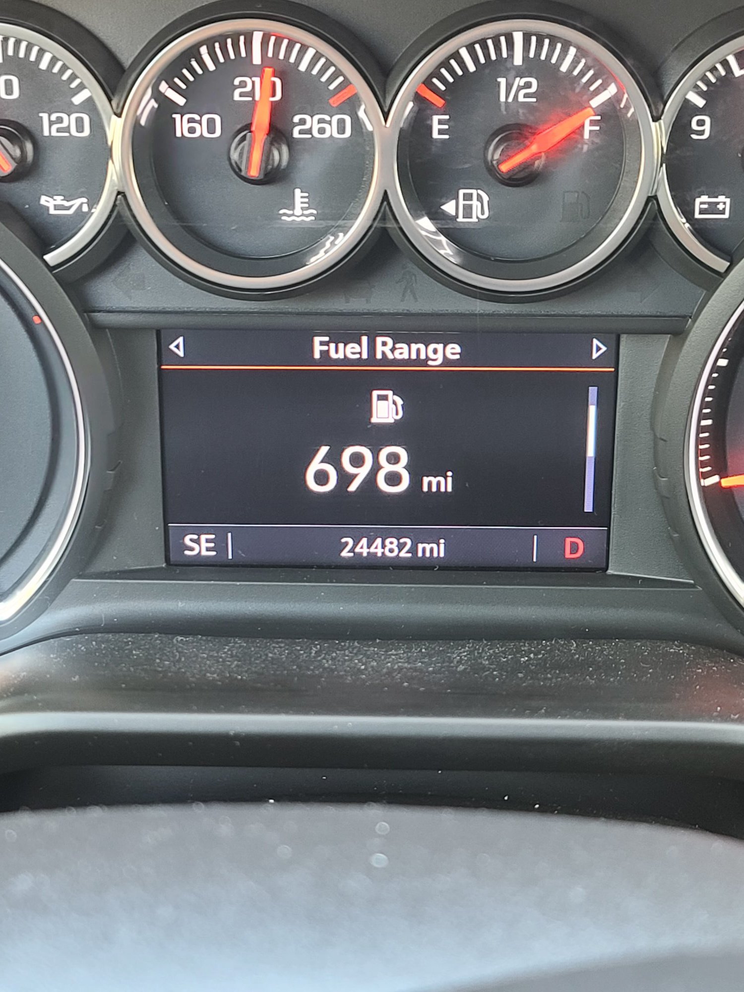

On 4/19/2023 at 3:47 PM, redwngr said:
It's gonna depend on the 'recent' fuel economy the vehicle has been getting.
I regularly see 700 miles to empty.
I have the stock tank and see this every so often. Here's one of the times i actually took a pic of it.  I consistantly get 28-33mpg, and when tank is close to empty or get the fuel low light, i only put in 19-20 gallons tops.
