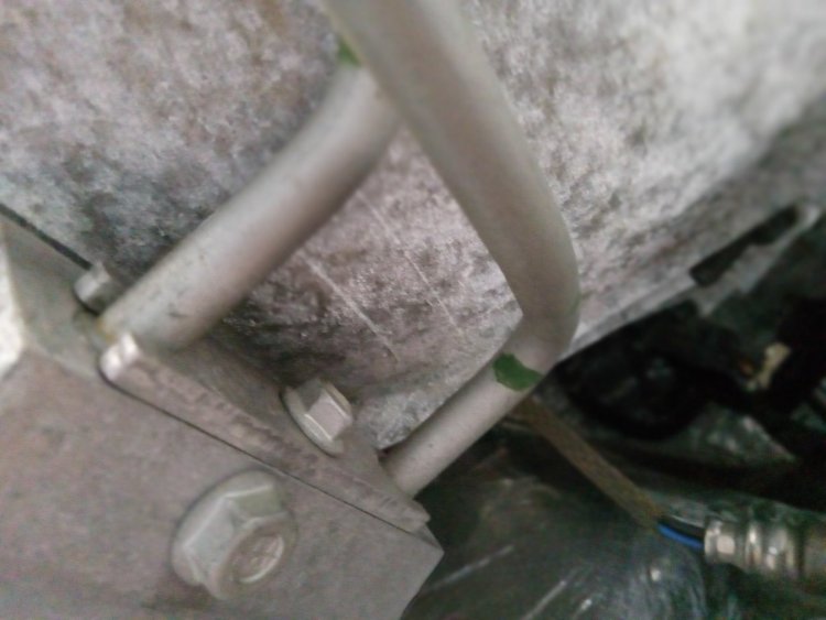

Additionally, for those not lucky enough to have the 4.3L like we do:  my 2015 has the plate style retainer on the Transmission bypass valve.  I can't remember where, but apparently some 2015's might have the clip retainers instead.
You are welcome. Pepper is as much a hobby as a truck. Mine has the plate like yours as well. 2014 was clipped. Do some early 2015's have clips? :dunno: That would be a @newdude question. He's really active here and I learn allot from him.

I think early 15s do?  They changed somewhere in that early 2015 build phase.
Then the other change on V8s was the lines flow differently.  14-early 16s the transmission goes to the radiator then to the condenser combi cooler then the transmission.  Late 16-19LD they bypassed the radiator and its standalone transmission to the condenser then back.  When the pill flip/sure cool are done on these they run real cold come winter time.  15-20F mine wouldn't get past 100F and shifted laggy due to the low temp.  I ended up installing the GM revised TBV and winter performance improved.
