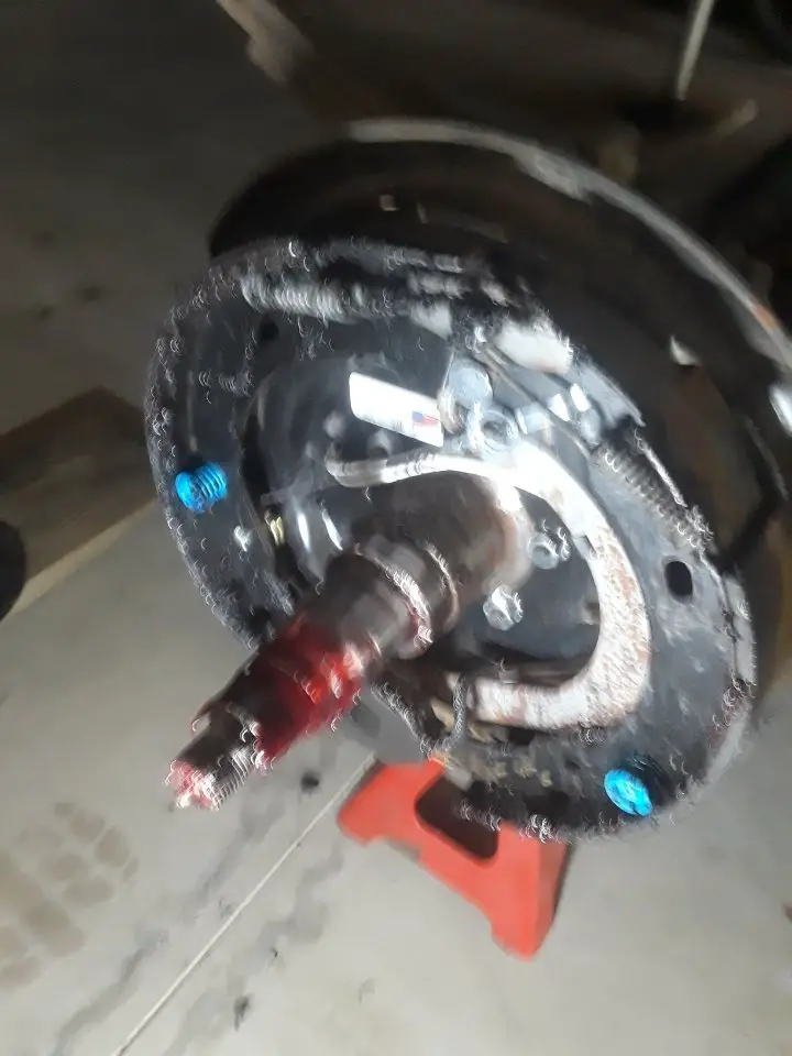

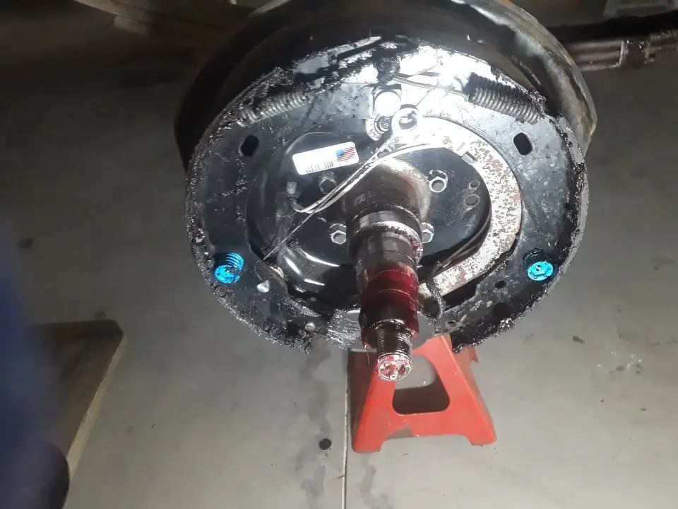

Electric trailer brakes must have thewheel in motion in order for the brakes to apply (at whatever force they are set at) it works on a lever type effect that then applys outward force to the shoes.
Unfortunately I think your problem goes deeper than settings. My last 3 trailers (2012,2018,2021) all had the rear seals blown out by an overzealous person power greasing the hubs, who knows where and why but the brakes were all coated and 2 required a complete replacement of the brakes. The last 2 trailers were a Grand design Imagine 2600RB and a Reflection 337RLS. If I read everything correctly the next move will be to tear the brakes apart and inspect them. If I was going to Vegas I would put $100 on the grease issue. This is why I hate the EZ lube system.
No amount of gain will overcome greased brakes.
I won't have a chance to try them out the "right" way until this weekend.  If I'm still having problems off the drums come to see if the pads are covered in grease.  Thank you for the tip.

Another pic rightrearbacker.thumb.jpeg.eafc9a283d941750233af9a8594f416d.jpegrightrearbacker.thumb.jpeg.eafc9a283d941750233af9a8594f416d.jpeg
Damn, that's not good.

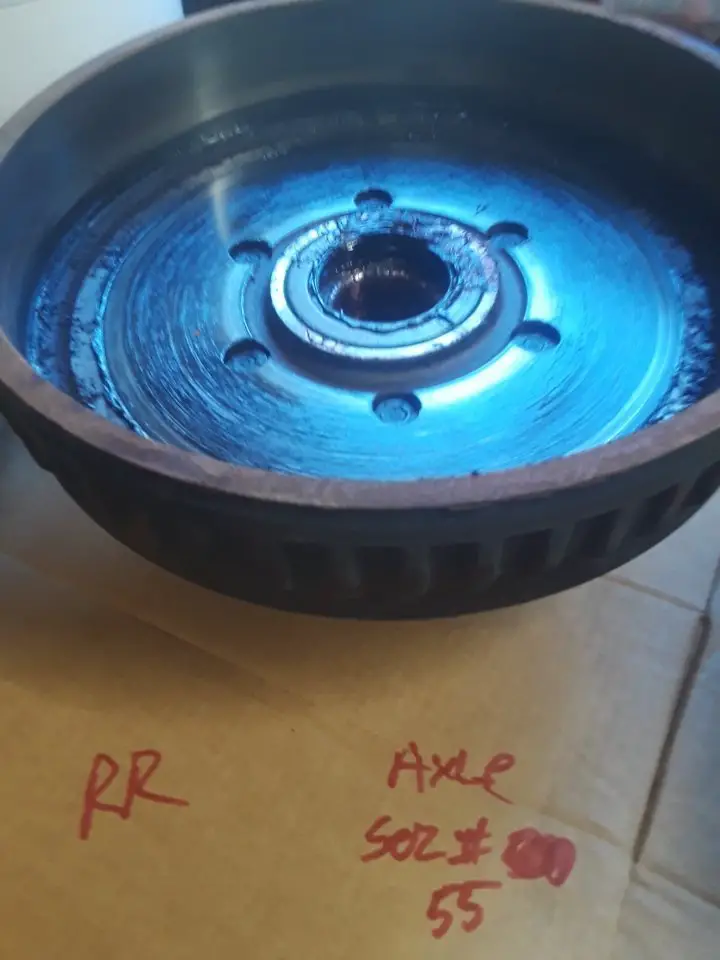

One of the drums on my 337 was so badly soaked that Dexter even replaced the entire drum/ hub assy along with the bearings. I figured the retail on the parts was over $600 plus they paid me almost $100 for me doing the work myself.

That's amazing that they at least threw you some money to do it yourself.  I do love that!!
