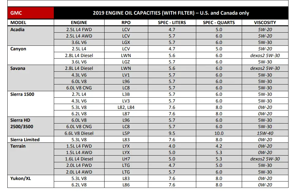

I have a 2019 Silverado 1500 LD (old body style) with a 5.3L with a little over 63,000 miles on it.
My manual says 8 qts of 0W-20 however when I fill it with the 8qts it’s way over the line. The first time I changed the oil I read every article and forum post to make sure I wasn’t wrong and 8qts seems to be right.
I started to notice a pretty bad oil leak from the back of the upper pan and from what I’m reading that could be a rear main seal.
So my questions are has anyone else experienced this level of leaking for what I think is so early? Is 8qts too much? Could I have the wrong dipstick (V6?)?
Thanks all.
5.3L 'way over' with 8 qts suggests that it wasn't fully drained.
(one of the reasons it's common to check level to determine how much of the last bottle is required.)
I'd prefer to be a 1/2 qt below full (so middle of acceptable range) rather than 1/2 qt above full
Techlink chart shows:
