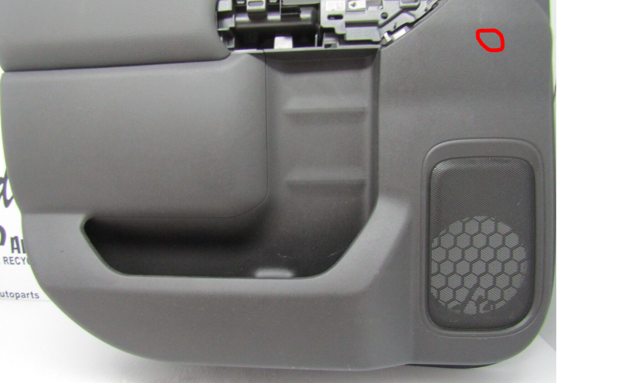

I put my rear tweeters here (circled in red):

@jashaw Hey thanks for the info because I am doing components in the rear and front. I was mounting the tweeter easy there? Also I did have an llj loop but they never sent it after waiting 5 months. I’m using a different company harness now. Did you use an rta for tuning ? What signal did you use for your sub signal

Yes, just need an appropriate size hole saw to cut out the hole for the tweeter.
