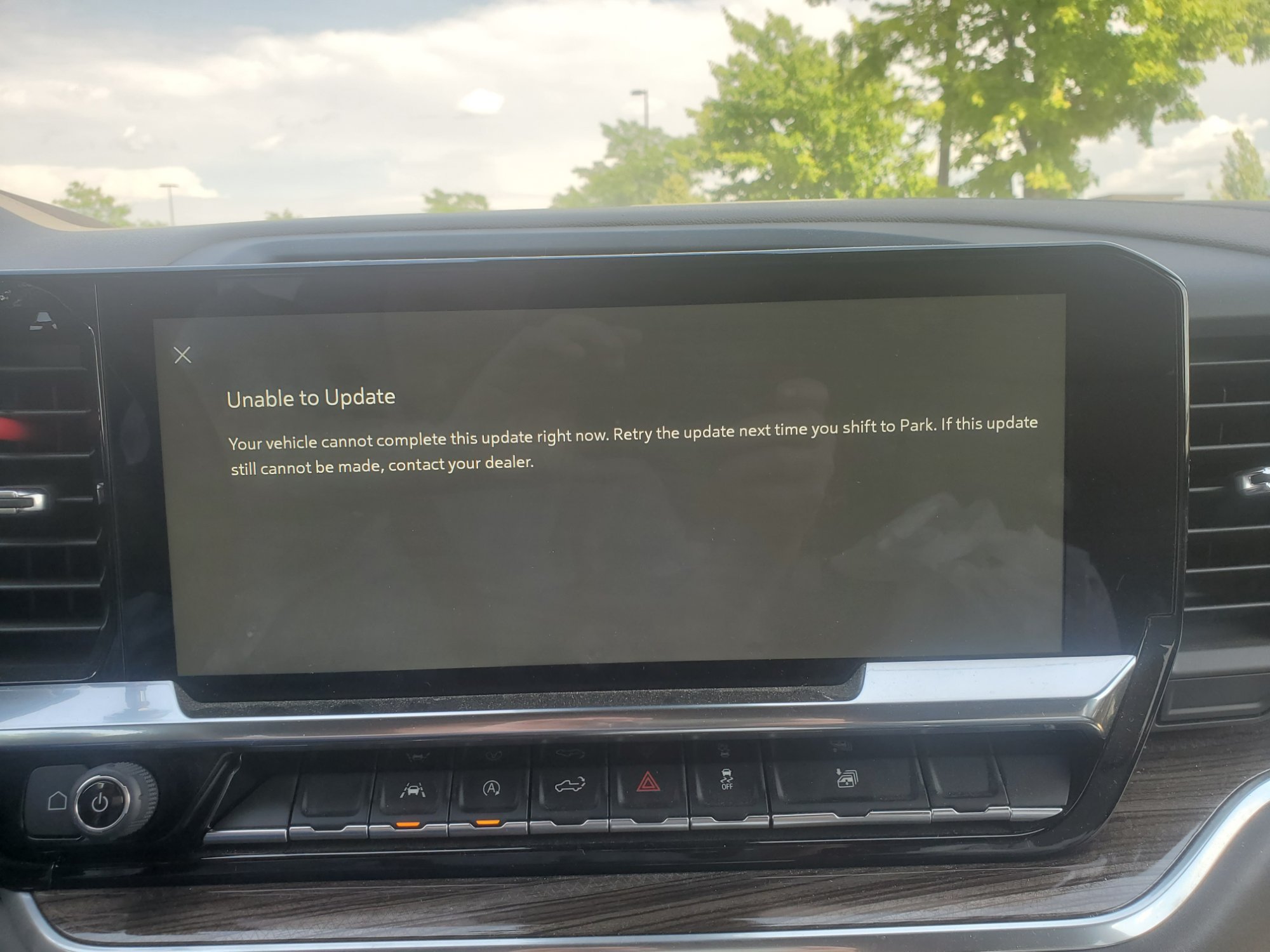

I have been unable to install any OTA Updates using the Infotainment system on my 2022 Refresh Silverado 1500 LT.  I've spoken to OnStar and they referred me to a Chevrolet Dealership's Service Department and the technician allegedly looked at the system and said the update (GM N22-2379480GM) was already installed.  Well, I received a notification through the My Chevrolet App a few days ago letting me know that the GM N22-2379480 update needed to be installed.
When I attempted to obtain the update via the Infotainment system yesterday, I took a couple of pictures of the screen.  The first picture is the screen for Vehicle Updates.  As one can see, the wording "Check for Updates" is sort of greyed out relative to the wording "Vehicle Updates" and "Preferences".  When I touch the "Check for Updates" wording, I get the message "Unable to Update" with other words following as shown in the second picture.
Before I contact OnStar or return to a Chevrolet service department, I have a question for my fellow Silverado Owners:
When you have performed an OTA update, is the "Check for Updates" wording as bright as the other wording on the touchscreen or is it sort of greyed out?
Thanks all!

Earlier today I received a phone call from OnStar’s Technical Assistance Team letting me know that they are working on my OTA Updates not updating issue, and that if they cannot figure it out remotely and solve it remotely, they will be turning it over to GM Engineering for resolution.  They estimated a 1 to 3 business day resolution.  I was also asked to email them pictures of the Infotainment Center Screen with the Updates screen and the error message screen.
Late this afternoon after having run a few errands, when I parked the Silverado, a never before screen popped up after I turned off the engine but before I opened the door.  This new screen indicated that there was at least one update that was ready to be installed.  I went ahead and pressed the area of the screen to OK the update, but the next screen was a new error message indicating that the update could not install.  I restarted the engine and attempted to install any update through the System, Update menus, but alas, no such luck.

Well, I received a phone call from OnStar Technical Assistance Team letting me know that they believed the problem was due to a low state of charge on the battery, and requested that I drive the truck on the highway for 30 minutes with all accessories off, and then park and try to connect to the OTA Update System.  Instead of driving, I put a battery charger on the battery for 4 hours (at which time the battery charger indicated the battery was fully charged).
I started the truck, moved to a shady spot and then went into the System Menu in the infotainment center, selected Updates and son-of-gun, Check for Updates was no longer greyed out.  I pressed Check for Updates, a rotating circle appeared and then another screen appeared stating “Your Software Is Up-To-Date” along with the Android version, Security Level and the date time when the system was last checked.
I knew that these vehicles were really sensitive to the battery’s state of charge and it’s voltage, but man, this is hypersensitive!  Guess this means using a battery maintainer when it’s not being driven.
