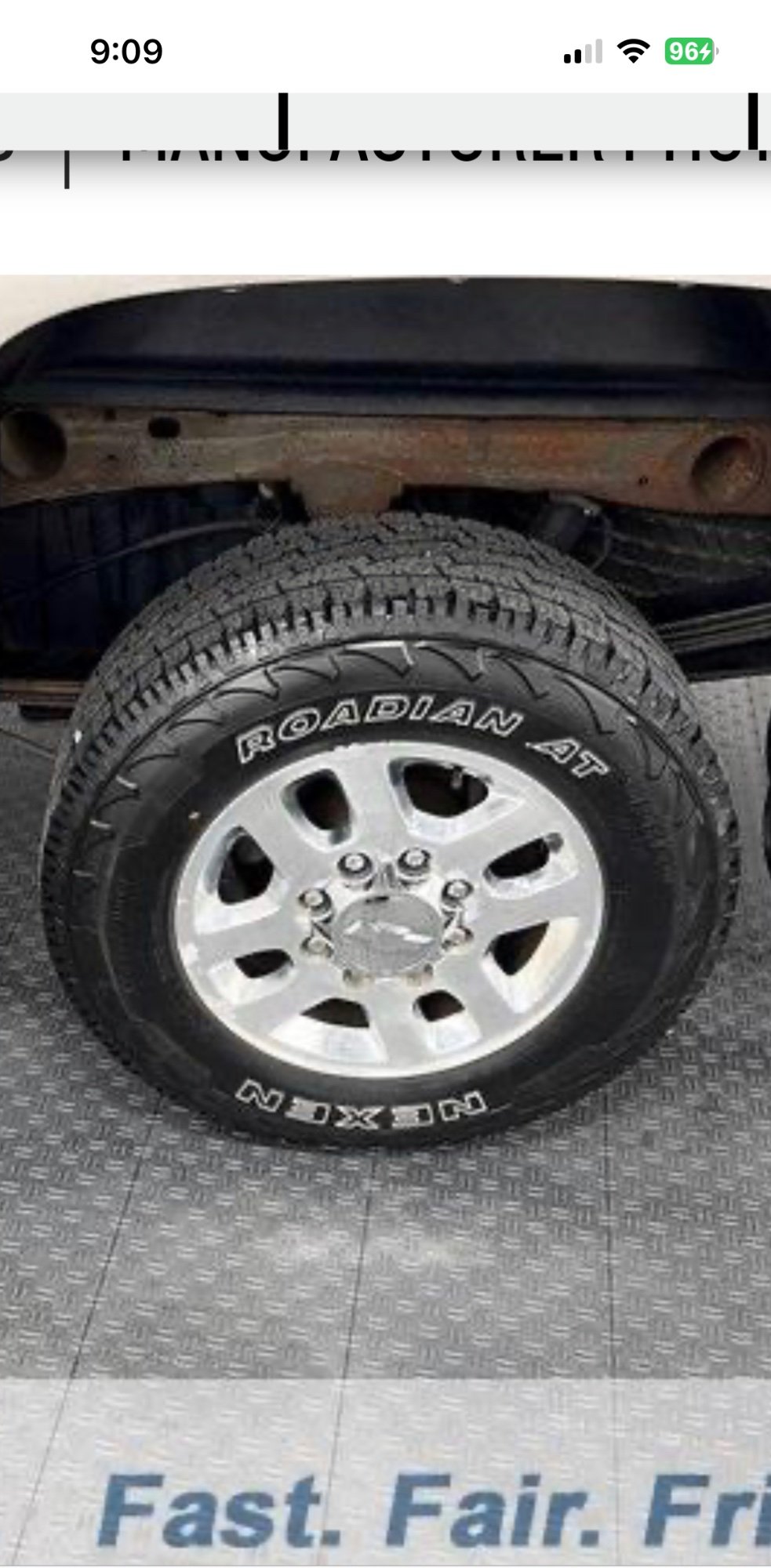

3 hours ago, 05 1500HD said:
This is one of the pics on the 14. Does this look like frame rust to y’all?IMG_3028.thumb.jpeg.e6dc4719c665b8e2ec43bdb5c3b7b680.jpeg
Definitely surface rust at a minimum (orange/brown spots).  The grayish looking area is dried and dirty frame wax most likely.  Perhaps was a coastal truck so exposure to salty sea air?
Looks mint to me.
Come to Minnesota if you want to talk about what we qualify as rust.
