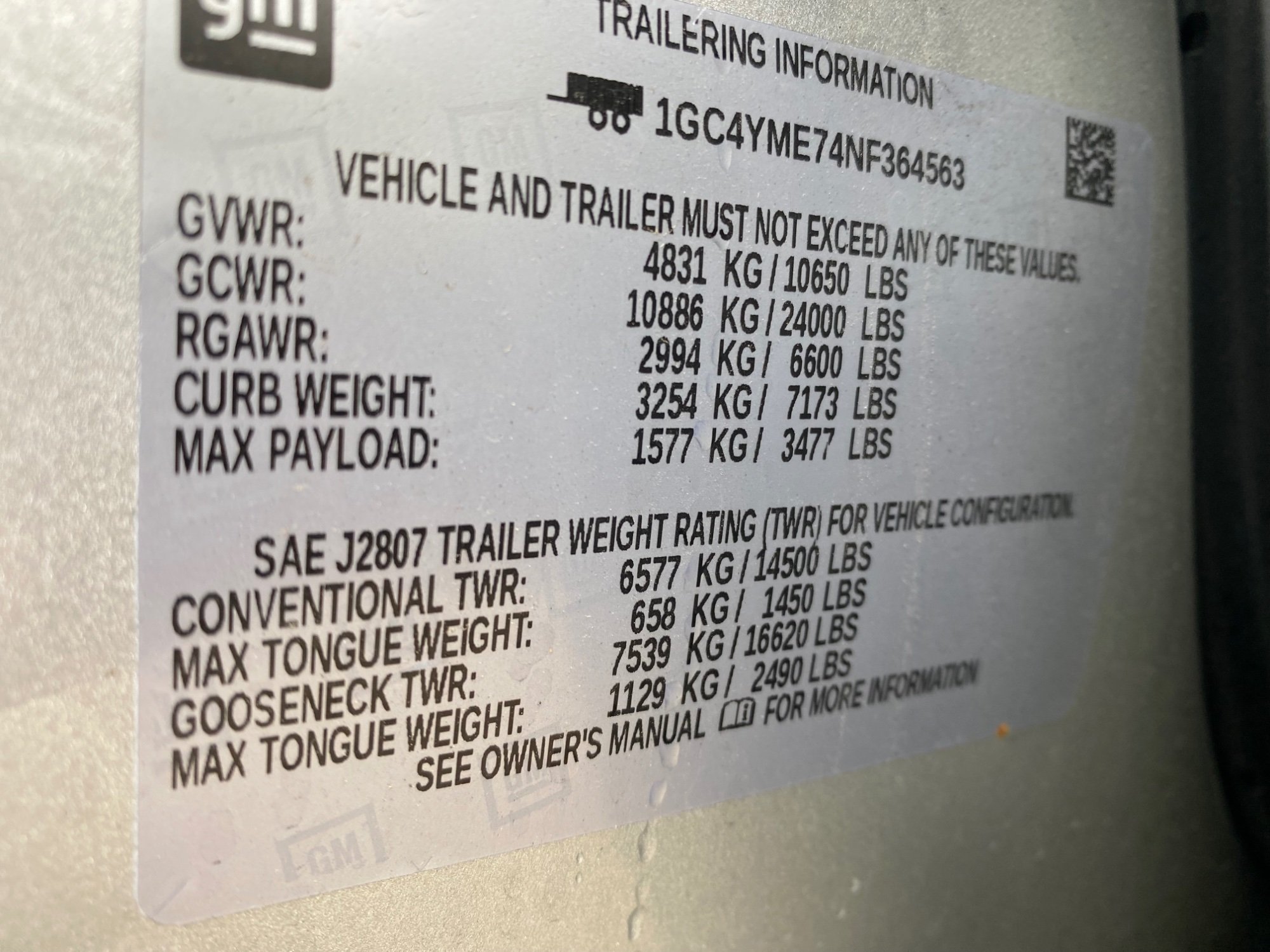

Max payload 3477, so i should have a couple hundred pounds (not much) .
gcwr is curb weight + camper + trailer? 7173 + 3037+3000 trailer = 13210. Gcwr is 24000?
GCWR is gross combination weight rating. It’s your truck weight plus any weight it is carrying plus trailer gross weight. You are well under GCWR as you showed because your trailer is light.
Another concern will be whether you are exceeding the payload rating with your passengers plus cargo plus camper plus trailer tongue weight.
Finally, you will want to ensure you don’t exceed the rear gross axle weight rating because your camper puts most of its weight on the rear axle and your trailer tongue puts more weight on the rear axle. In fact, because the hitch is several feet back from the axle, the load added to the rear axle by your trailer tongue is about 20% higher than the tongue weight itself, depending on the wheelbase and the rear axle to trailer ball distance.  I suspect this will be the limit you are potentially going to run into. You might exceed it by a few hundred pounds.  This is why most people with heavier slide in truck campers buy a one ton or even a dually.  That’s without adding trailer tongue weight into the situation.
Does your little trailer have brakes?  If not, from a braking standpoint you would exceed the design intent by having the truck near max GVWR and having the brakes have to stop 3000 more lbs.
Lets just assume your trailer is sitting at 10% tongue weight, so 300#.  Your slide in is 3037 plus the 300# is 3337#.  Truck payload is 3477, minus the load of 3337 is leaving you 140# for passengers, luggage, dogs, bicycles, coolers.  I'm assuming your slide in will have water, bedding, dishes etc that all go against your payload.  It is safe to say, without a doubt, you will be over your max payload for that truck.

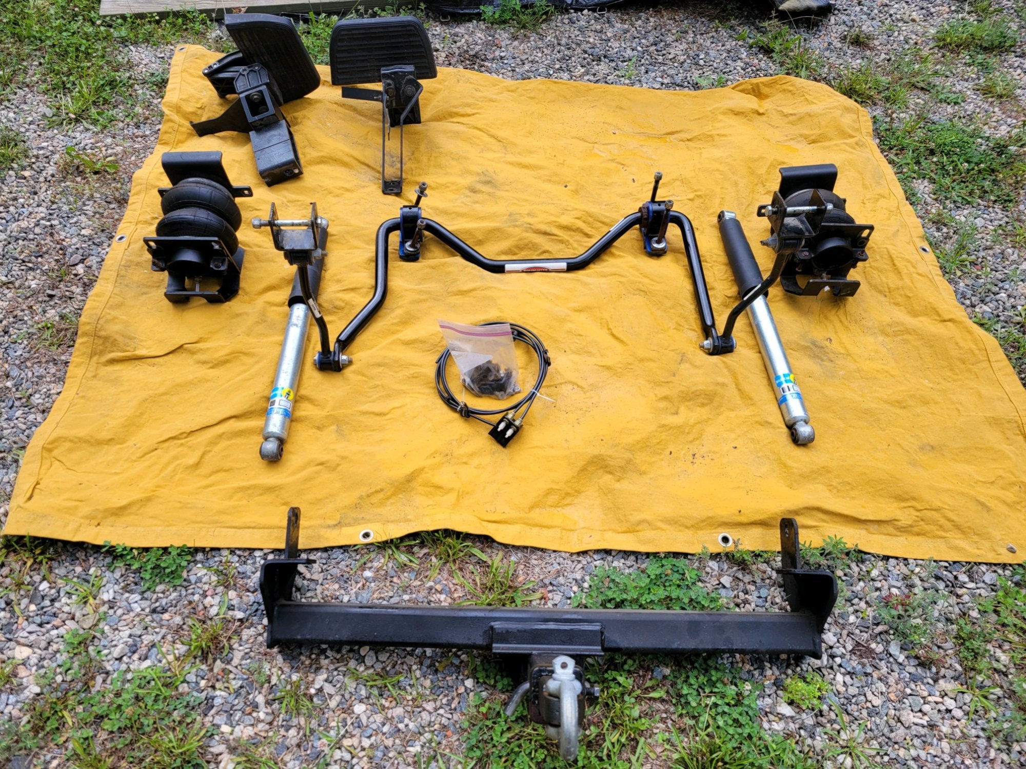

Yes you are in a tight load limit with even the camper. Pic of the rear suspension upgrades I did to my '16 2500HD Denali Duramax Crew.  Just with a std. fiber cap, steel tool bed slide out and my work tools. No 3k lb. camper, and I thought this truck handled like Pooo. On moderate bumps, the rear would bottom out and  hit the rubber bump stops !!
I put aftermarket sway bars (anti roll bars) on other trucks I've owned in the past, including a motorhome. So xxxxx-off at how my new 2500 HD handled, I put on a Roadmaster 1.50"  rear sway bar , Firestone 3500 Lb. Air Bags, and Bilstein gas shocks. Night / Day difference !!!!  These parts on an oiled tarp, after I got "T" boned at an intersection by runner of a red light. Truck totaled
My '24 2500 HD Denali Ultimate Duramax should be here this Tuesday. I ordered it with the Max Trailering Pkg. #NHT, that includes a 3500 HD Frame, 3500 HD Rear Leaf Springs & Overloads, 3500 HD Shocks and 12" Axel. I also ordered the Front Camper HD Spring option # F60.
Now with this factory super rear end capacity option for a 2500HD,   I only ordered a new Roadmaster Rear 1.50" Sway Bar (now should not need the air bags for my application).

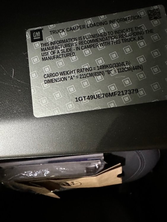

And... if one is putting a slide in camper into the truck bed vs towing a trailer, one might be surprised by the actual slide in camper payload listed by GM.  Yes the pillar sticker has the numbers, BUT in the glove box of my 2021 2500 Duramax Crewcab is a sticker specifically with a load rating for a slide in camper.  The number is quite different than what is put on the pillar.  Yup... less!
That was news to me... so if one is using a slide in camper in the bed vs towing a camper, suggest to check the GM sticker in the glove box and see what the truck is rated for that purpose. I love my truck but was quite surprised to see a difference.
Edited by Terry OBrien
Payload rating is simply GVWR minus curb weight. The camper rating in the glove box is trying to keep you within the GVWR by giving a margin for people and gear in addition to the camper.
On my 3500 hd cclb srw gas, 11,500 lbs GVWR, the payload rating is 4,054 lbs and the camper load rating is 3304 lbs.   That looks like an arbitrary 750 lbs reduction below the payload limit to account for two people and gear. It doesn’t seem to be driven by the rear axle 7250 lbs rating which has nearly 1000 lbs of margin even if all 3304 lbs of the camper weight is on the rear axle.

These are from my 2021 truck mentioned above. My 1993 K2500 has a similar sticker in the glove box. GM has been providing a camper weight recommendation and camper acceptable cg range for a long time. Note that the weight sticker in the door opening states ratings as limits, while the language of the camper sticker is a recommendation.

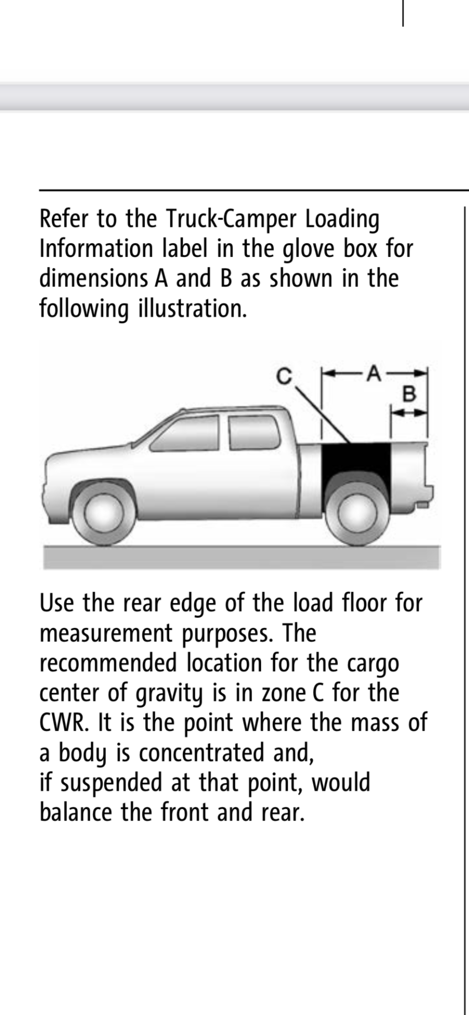

Interesting!  Guess I always figured it was simple enough to take the GVWR minus the curb weight to get the payload, so long as it didn't exceed the GAWR.  Is the dimension 'A' not centered over the rear axle?  That's usually the base line assumption - that the camper CG needs to be at, or forward of, that point.
The thing that bugs me is that having had a camper, and having put it across CAT scales... I don't really see where there's all that much weight being put on the front axle - and so far as I know, the 'camper' package for Ford and Chevy/GM is mainly just some extra suspension up front.  Maybe it matters more in an emergency braking scenario?
The frustration for me is that I'm having a hard time finding the truck I want (long story), partly because new or even late model duallys are kind of scarce, more so with the camper package already installed.  Not super enthused about having to order and wait.  And wait.  And wait.
Here is the owners manual page describing what the A and B dimensions mean. The acceptable CG range on my truck ranges from directly above the rear axle to about 16 inches aft of the front of the bed.
A hard sided bed length slide-in with a large cab overhang, such as a Lance 850 will put 200-300 lbs on the front axle. Bigger 10-11 foot campers have their cg just forward of the axle so the addition to front axle weight is again just a couple of hundred lbs.
As you point out, that’s in static conditions. If you slam on the brakes the front axle load is affected much more.  The camper manufacturers don’t list cg height, but just ballparking it assuming the cg is 6 feet above the ground when a 3600 lbs camper is installed in the truck, a hard stop at 0.5 g deceleration rate adds 750 lbs of vertical load to the front axle in addition to the static weight. That’s one of the times those front camper springs would make a big difference. The other is lateral stiffness.
