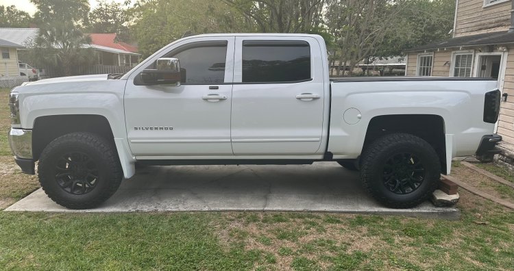

Just put a 6 inch lift and 35s on my 14 1500 and now i gotta do a norcal to gain clearance in the rear of my tires but what about the front?? I already had to trim my bumper corners but im still rubbing on the fenderwell in the front
Take a long zip tie and connect the fender liner to the bar behind it and pull tight!  I think i had to make a small slit in the liner to run the zip tie.
Wait, what? I'm running 35s on a 5.5" overall lift and all I had to do is trim a bit of the front wheel well liner at the back of it.
Ah, you must be running an offset on your wheels that's not compatible with your lift.
