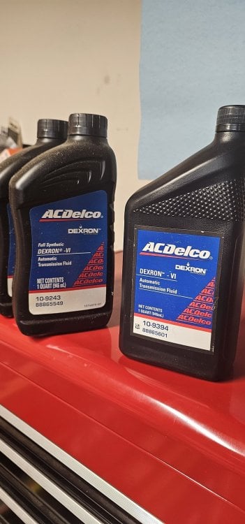

It was time to service the transmission with new fluid and filter. I went to rockauto and ordered 7 quarts of ACDELCO Dexron-VI transmission fluid, part # 10-9394 and a gm filter 24258269. Did the service, kinda easy except for the checking of the fluid. Not hard just inconvenient how its suppose to be done. Everything is great right, well I forgot to account for the transfer case as well so I didn't have enough fluid to service that. I went into my garage to see if I possibly had some left over tranny fluid from previous vehicles (I've always owned GM products) and sure enough I did! HERE IS MY QUESTION........ what I have on hand is ACDELCO Dextron VI part # 10-9243. Different part number from what I ordered and already put in the vehicle? Is this a major screw up on my part? What is the difference between these two??? Can I use them interchangeably??? I know one says full synthetic but I was under the impression all dextron VI was full synthetic??? See pic for reference
I wouldn’t mix fluids in the same system even if they meet the same spec. The transfer case does not share fluid with the transmission so no problem using your different part number fluid for that.  The other concern would be age of the fluid if it has been sitting several years. Do some research yourself if your fluid is older, but I’ve read recommendations not to use engine oil that has been on the shelf more than five years. One of our resident oil experts here may have advice on that.
Mixing the fluids is my main concern. Of course it was unintentional. Someone can correct me if I'm wrong but when you drop the transmission pan and replace the fluid and filter, your only seeing 1/3 of the total capacity ( I many be wrong on the amount, my point is its not all of the fluid). So I wanted to stick with the OEM which is why I chose ACDELCO "brand".  That's why I made this post to figure out if these 2 fluids are indeed the same and just different and/or "revised" part numbers. The fluid is about 3 years old but my assumption is that trans fluid has a relative long self life. Thanks for the input!
I would not be concerned at all using 3 year old fluid from sealed containers.
Nope. Dexron VI is a viscosity and additive spec, not a base oil spec. ACDelco Full Syn is a Group III and will take more heat than the Group I/II mineral variant. They can be mixed without operational issues. Add package is the same and blender blend various fluids all the time. Got an old SEALED bottle? Shake it well and use it.

Sounds good thanks for the info. Kinda wish I had chosen the "full syn" but at this point it is what it is!!! Hopefully this tranny will last well past 100k, time will tell.........
