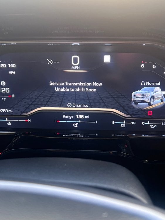

I received this very odd message on my Wife’s 2021 Tahoe this afternoon and was curious if anyone has seen this on your 2019 up Silverado’s or Sierra’s who have the 10 speed transmission ? If so, how did you address it?
the only strange thing is the weather is at 15 degrees today, I have had cold weather play games with an old Silverado I had. Any logic to this you think?
I am just trying to get insight from someone who had this issue or maybe a GM tech as the mileage is 63,000 (3,000 out of powertrain warranty).
Thank you for the help!
I guessing here but I think you could be right about the weather. These transmissions software are adaptive learning and it being a huge change in weather might have it where it change in what its use to seeing from the driver. I know extreme weather can affect a lot of things.

Good thoughts there @Mshawn This cold is definitely an occurrence here that I can count on one hand (and still have fingers left), so this is why my mind went that way. However, I don’t want to ignore it either if it is due to something serious, hopefully there will be someone to come across this who has seen this message before and provide some feedback.
I’m interested in this as well. Knowing what I know about the electronic in these vehicle and adaptive learning, I’ve seen a lot of weird things in vehicles. Also this may be the nature of your trucks adaptive  learning but the same identical vehicles be just find.

Can you scan the Tahoe for codes? Generally "Service Now" means shut down to prevent further damage. I would get that truck to a dealer now.

as Bikerjon stated, this problem can be caused by several different things. no tech is going to give you the magic answer. cold weather can cause seals to leak and low pressure in the tranny, solenoids to stick and other problems. no magic answer here, get it scanned and go from there

Wondering what the outcome of this msg was, I’m in same situation first time it’s been 27 degrees over here since I’ve gotten the truck. Truck only has 12,****** miles on it so might take to dealer.

Sorry for the bad news, Frankie, but mine - and evidently many others, failed in much warmer temps. See this thread.
Well I just started my truck drive few miles the msg hasn’t popped again, how many time did u see that msg before it actually messed up so started see problems?
3 hours ago, Dan H 2023 HC said:
Mine started having problems the moment that message appeared, and the trans was obviously not shifting correctly.
****** idk mine hasn’t said it again, driving good no hard shifting but i did notice that my battery was alil low today.
