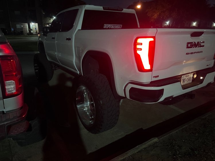

If u mean will they fit yes, will need conversion harness and the 2024 OEM LED 2500 truck harnesses (one for each taillight). Phil Gamboa had his hyperflash deleted on his truck and they work perfectly WAMS help him with his I believe (mine has a hyperflash still was told I had to have the dealer program mine but I haven’t taken it)IMG_5542.thumb.jpeg.faa630ee2e13b6cbfcd3614cc0d63dba.jpeg
