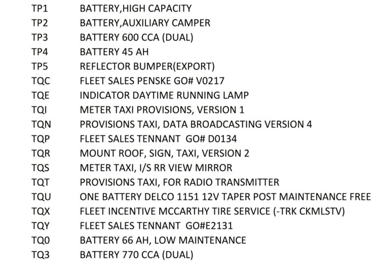

I recall from back in the day TP2 was the common RPO code for dual batteries on our broadcast sheets. Nothing like it on my truck or from this list:
2024 2500 battery codes
and alternators
and rpo's starting with T

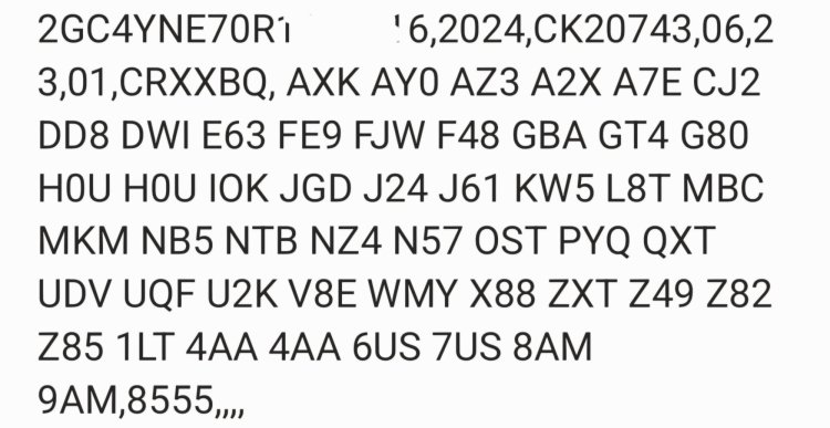

Interesting that KW5 is listed, but no sign of K4Z.
Also my truck does have Intellibeam lights, but no mention of TQ5 on the RPO list. That being said, the window sticker lists Intellibeam as standard equipment.

I find that the qr code on the door jamb only lists some of the rpo codes.
Best to ask your dealer to print out the rpo codes from YOUR vin.
My salesguy printed the order sheet the day I ordered my truck. We went through everything on the sheet to make sure it was what I wanted. TQ5 is on the sheet for Intellibeam.

On 11/24/2024 at 2:40 PM, revrnd said:
I might be getting confused as to what we saw on the production side vs marketing. I know in the past (forgive me if I'm wrong) that you might see MX0 if you were ordering an automatic transmission, whereas in the plant it would be MD8 to specify which actual transmission was used in a particular model and/or behind a certain engine.
Ask you dealer for a copy of the build sheet.
As @gemarsh points out, the QR's seems to be a partial list.
Sorta like the SPID labels it replaces.
Perhaps because some RPO's imply certain others must also exist.

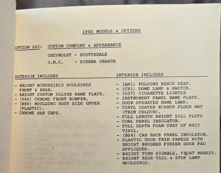

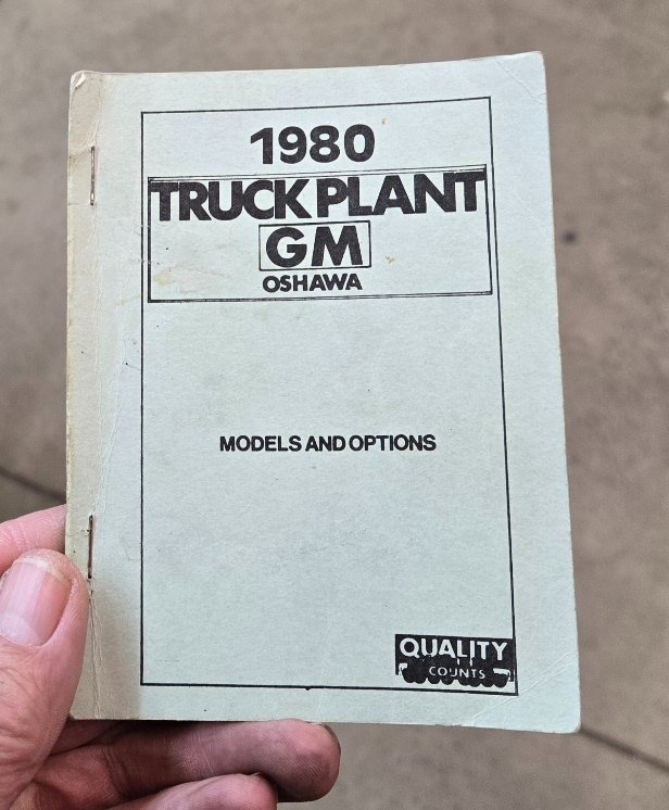

Maybe it's like this example from 'The Bible' back in the day:
A truck would show Z62 RPO code, but not the individual RPOs?
