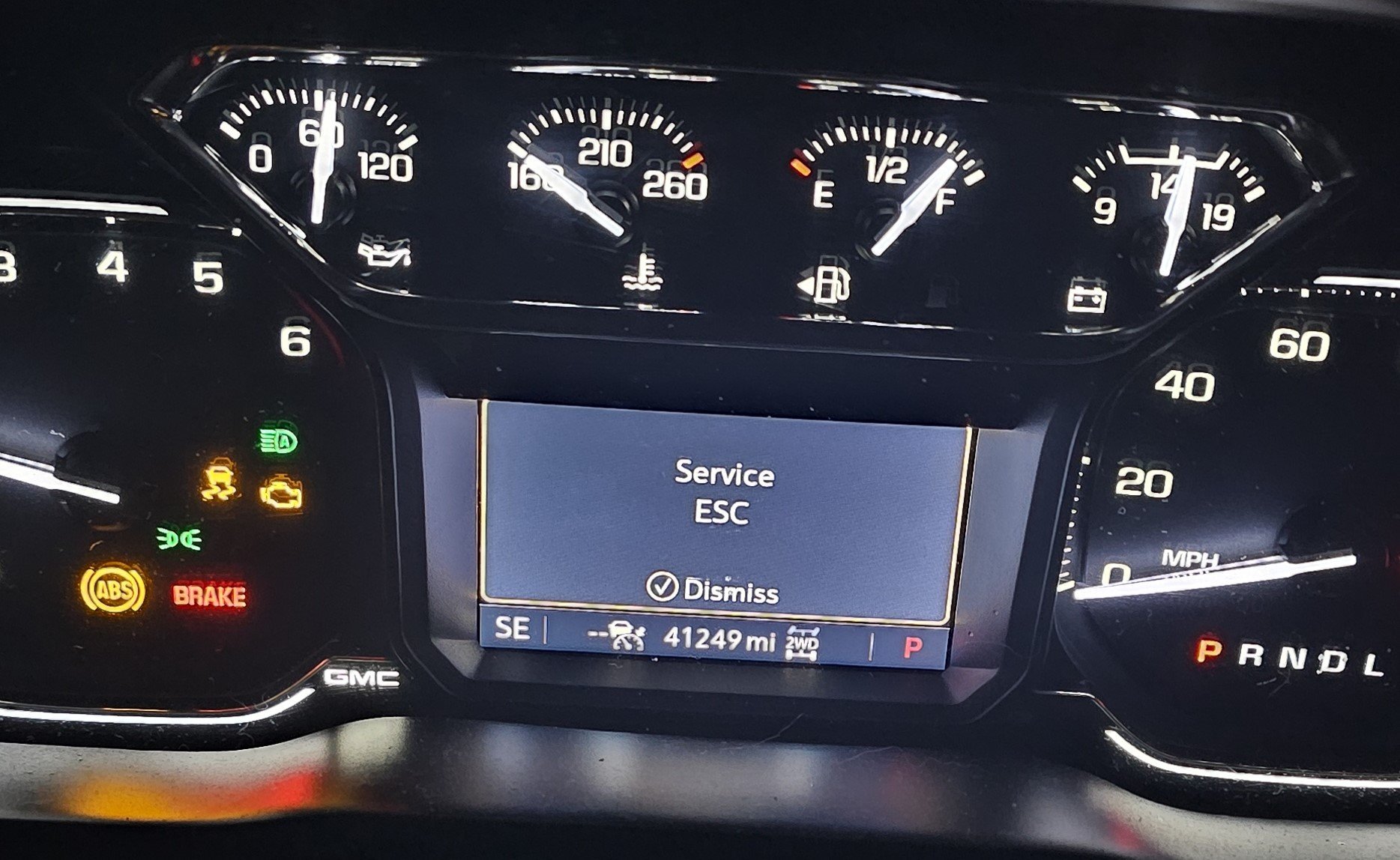

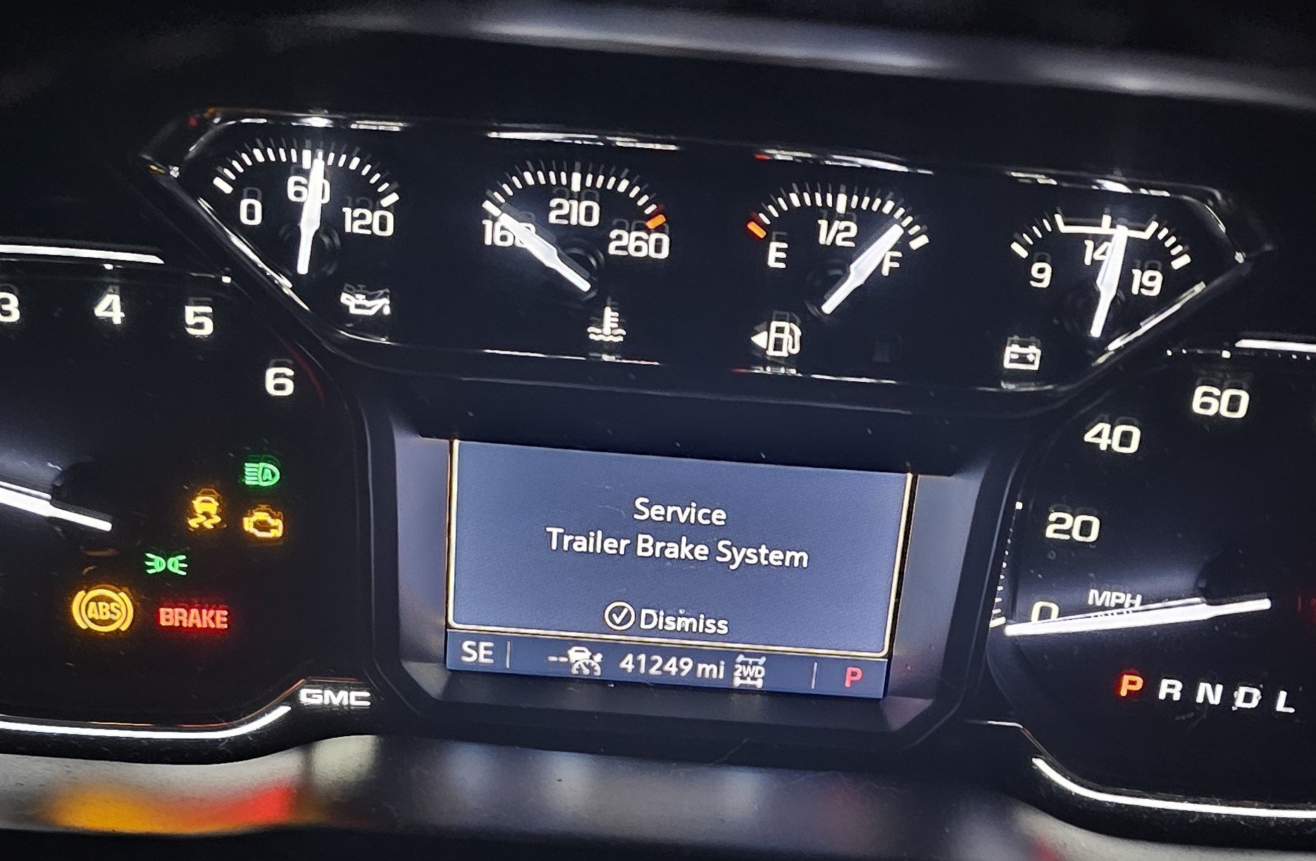

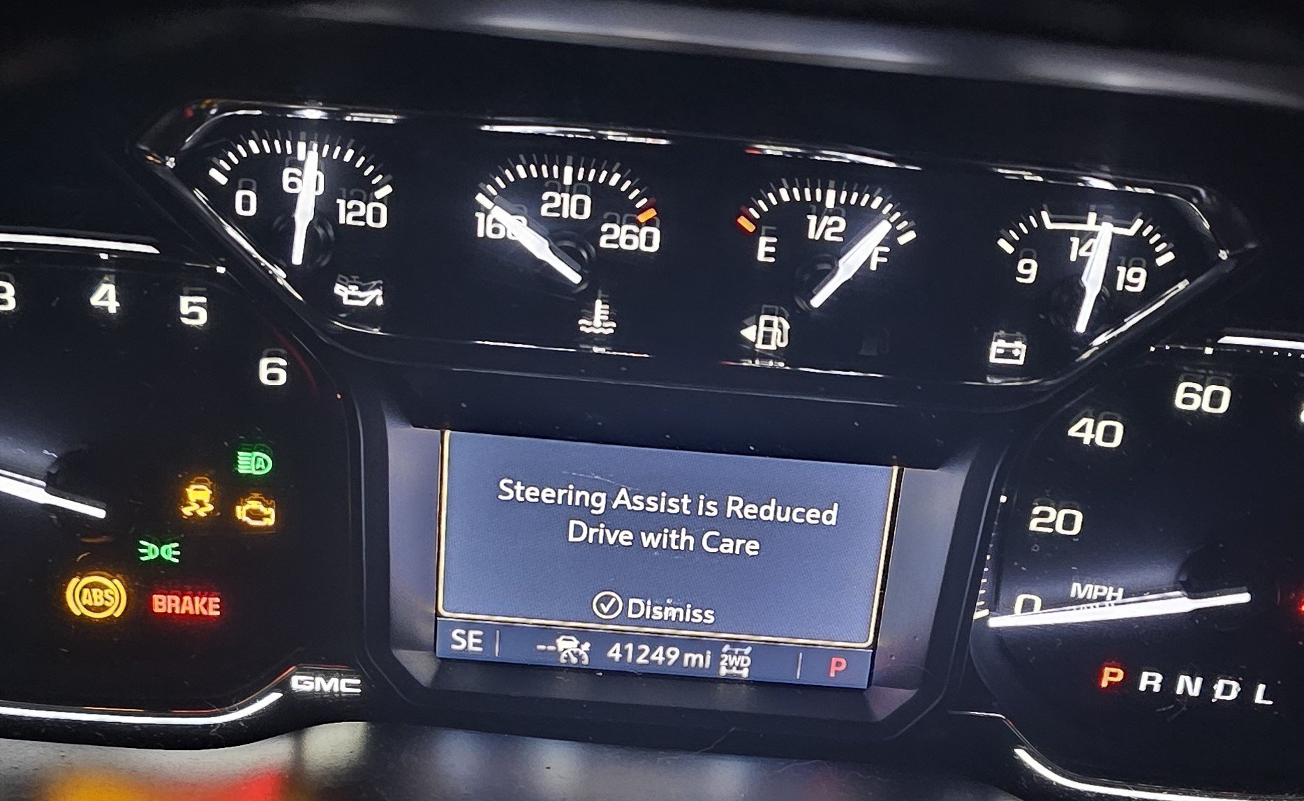

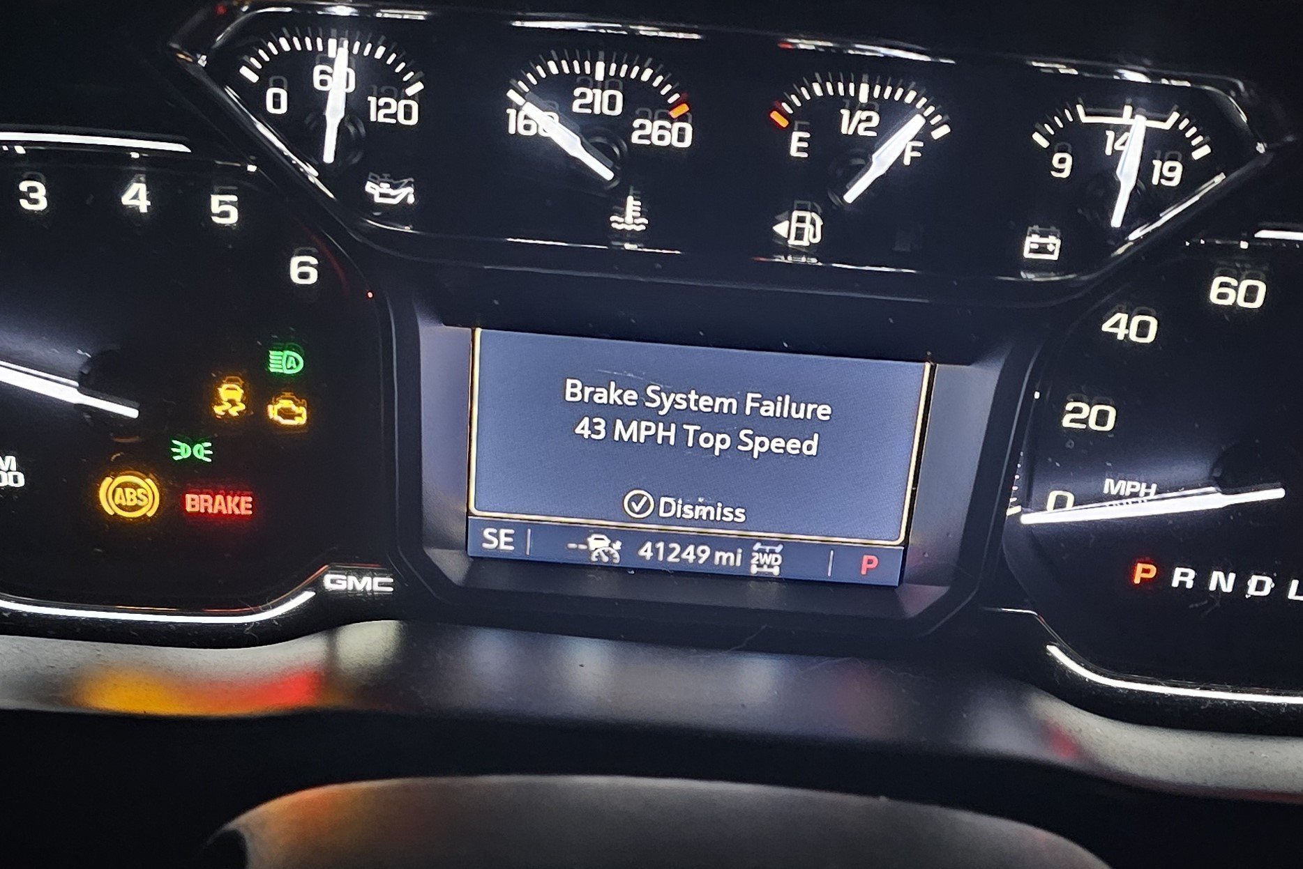

A few moments later ~ ½ mile, the truck felt like it was dragging the brakes, not the same hard braking as before, but even a slight release off the accelerator pedal caused the truck to slow down measurably.  Then the dash warning message started to appear: Service ESC, Steering assist reduced, Service trailer brake system, Brake system failure – speed limited to 43 mph.
