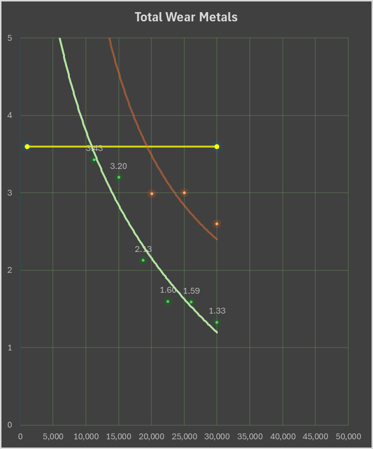

This is Mitsubishi I'm working with. Yellow line is the average recorded by Blackstone for the 3A9* motor they have on file using the factory recommended 0W20 weight oil. The orange is a fellow Mitsubishi owner with this motor on 5W30  and the pale green my motor on a Euro 5W40 after careful run in on 5W30 BREAK IN oil. The chart is capped at 5ppm/K miles per industry standard permissible limits. All three will meet the OEM 'spec' wear rate.
Wear in takes longer than most will admit to. When this curve bottoms it will start a very slow rate of increase until the motor reaches a point no longer in line with 'normal wear' rates and enter the 'wear out zone' with a sharper rise in rate show in the second graph below and affirmed in "The Oil Geek"'s latest video on the topic. 200K shown in his work as the point of inflection. That however is the "Universal Averge" because human behavours are indeed predictable and yet not absolute. That last word is quite important. YOU have control over that value and that work is confirmed by age old GM wear studies from decades ago.
Wear in is not complete until the slope reverses.
Slopes are created by subtracting the background elemental wear metals from the results and normalized to ppm/k miles.

my 5w30 is tracking less wear metals than your green at 15,000,  think?  napa dexos 5w-30
https://www.facebook.com/photo?fbid=10240827150721879&set=gm.25380156778344267&idorvanity=2098942210225719
Sorry, I don't Facebook so I can't see it. :( PM me a copy if you would like me to take a look. :)
Remember that wear 'rate' is specific to the Engine 'kind'. That is, an Ecotec3 based motor will wear differently than a Mitsubishi 3A9* or a Ford Coyote. It will also wear differently than an LS motor.
What you're looking for is what is 'normal' for your motor platform, in your service, with your fluid choice. Universal averages can be useful only as a motor platform guide. Not much to be learned between platforms.

This motor, the 3A92, mine, calls for a 0W20 oil. The chart here shows three different viscosities used in this motor. 0W20 line if from Blackstone's library. The 5W30 from an acquaintances motor who is as annal as I, and the last, 5W40 my personal motor. The "Total Wear Metals" chart I posted earlier in this thread.
Chart I haven't posted is the Iron level chart. What it showed was that bore wear was reduced by using 5W30 over 0W20 but little more was gained in the use of 5W40. Almost all of the Total Wear Metals reduction comes from the huge reduction in piston skirt wear....aluminum. Bearing wear is reduced with each increase in HTHS viscosity so a smaller portion of the total wear improvement comes from that.
Piston cleanliness has next to nothing to do with an oils viscosity. Cleanliness or lack thereof is a ring killer, a VVT-AFM-DOD solenoid killer and a cam chain eater.
The posted link hints at manufacturing putting the viscosity cart before the ability to keep it clean enough to support that weight horse. That has absolutely zero to do with piston wear. But skirt and land wear have EVERYTHING to do with ring stability and longevity and control therefore of blowby.
Dirty assembly will kill any engine on any weight oil. If the culprit is surface finish then viscosity is a card to be played.
Use the information as you see fit.
