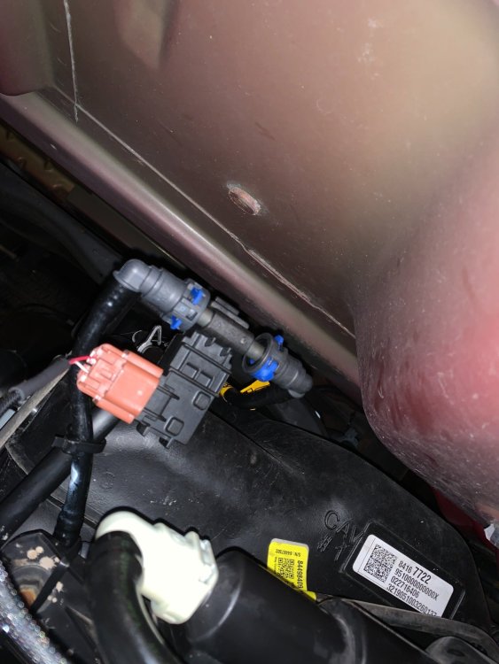

I bought this extension harness - LS LT Gen IV V 4 5 Flex Fuel Sensor Harness Extension – ICT Billet
Which allows you to use the factory plug where the flex fuel sensor would already have been.  I then bought the sensor and this pipe, p/n 23171534.  With that I did the heat it in water and straighten it method that someone either here or on another forum did which allowed me to put the sensor right in line off the fuel feed line from the tank.
You have to pop that tank line out of the bracket it sits in and let it twist a bit.
Kinda haggard a bit but it worked for 3 years no issues for me.  Came out like this:
  • Thanks 2
