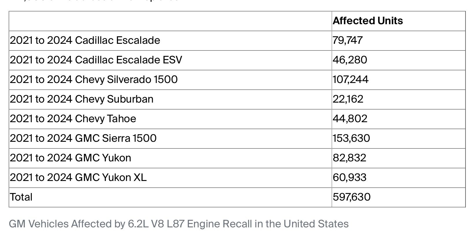

GMAuthority has published more on the recall. It covers GM vehicles with the L87 6.2L engines produced between March 1, 2021 to May 31, 2024. Total of 597,630 vehicles in the US.
Here is the breakdown:
