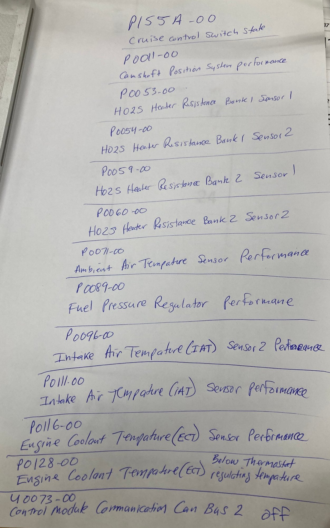

Tons of codes coming up! 13 to be exact. Any help on where to start troubleshooting on this would be appreciated! Truck seems to be running fine, was told by inspection it won't pass emissions until this is cleared up.
Vin
1GCNKPEH2EZ348666
See attached list of codes and descriptions
how old is the battery, with that many codes generally the bttery voltage is dropping below the thresh hold voltage that the modules need to communicate. if its ok then you need to start checking all the ground wires
