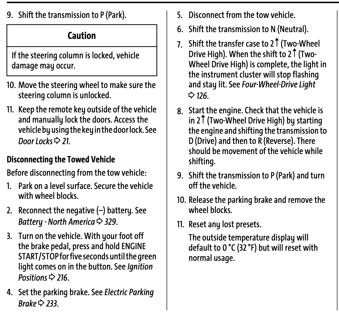

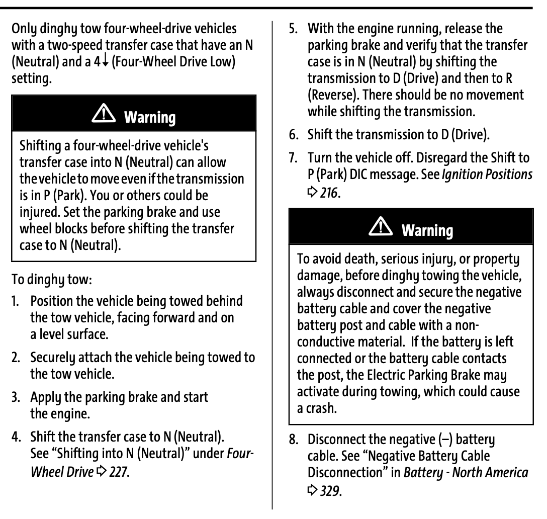

Did you disconnect the battery with the shifter still in 'D"?
image.thumb.png.089fbeb4dc3090eea744f43e7d3ddcb2.pngimage.thumb.png.d4fa5a0d84e45304bfebc785ad61af8e.png
