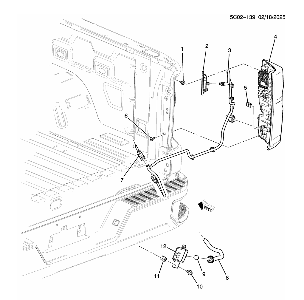

The LED tail lights on 2024+up HD are full LED.  No serviceable bulbs.  That socket that "rotates", that's the connector end to the wiring inside the lamp to the driver module and the LED chipsets.
Picture for refrence.  Also here's the microfiche from the GM Parts catalog for the 2024-up HD premium tail lamp (LT Midnight and Trail Boss/LTZ/ZR2/High Country).  You can see in the illustration that you can service the driver module, the truck to tail lamp harness and the license plate bulb(s).

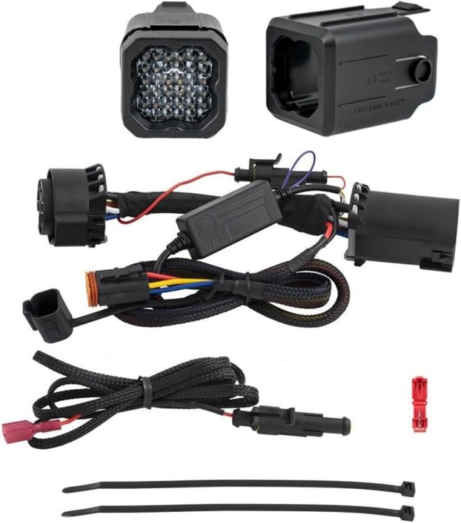

What I did is install a Diode Dynamics hitch light with back up. It is like a spotlight in reverse! It also gives you an extra brake light (my third brake light is blocked by my roof top tent).
https://www.diodedynamics.com/hitchmount-led-pod-reverse-kit.html

Yes, It is working great. I pop it out when the trailer is hooked up. DD has a little rubber cover to go over the connector when not in use. I drilled out the plastic mount and put my pin lock so no one steal it. The kit comes with a 2" and 2.5" mount so it fits in the receiver on the HD trucks. and other smaller trucks, it can be moved to another truck in minutes if you ever wanted to do that and leaves no signs that it was ever there.
It is very bright in all modes. Backup is amazing!
As mentioned before, I got this kit since I am blocking my 3rd brake light with my rack mounted tent. Our drivers are the worst so they need a bright red light in their face to avoid smashing into me!
The only thing it does is when I turn on the truck it senses something plugged into the 7 pin connector and thinks I have a trailer attached. I just ignore the message and it goes away in a few seconds.
Fitment was confirmed by Diode Dynamics tech support when I asked the question "Will this kit work with my GM 3500 HD?" The answer was yes and no need to cut or splice any wires.
