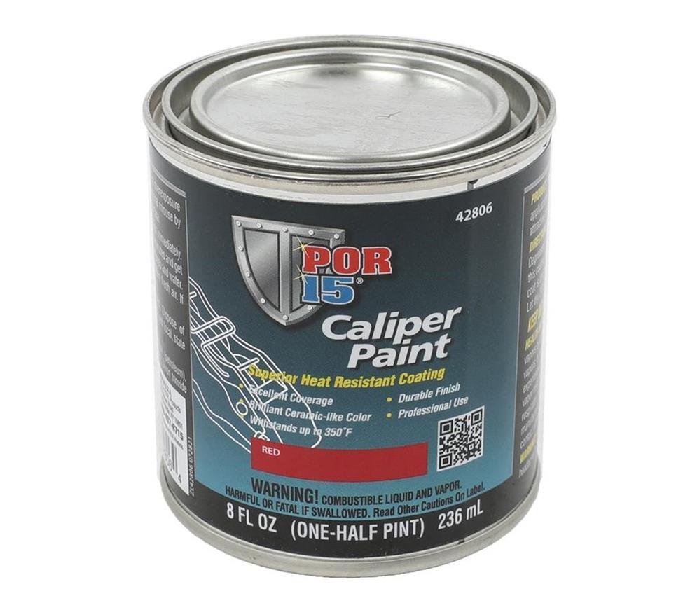

I have a question to the op, what is your technique in cleaning up a caliper and then what type of paint are you using, is it a high heat primer and then high temp paint and a high temp clear coat as well ?.
What doesn't look so professional is a caliper with quite a portion of the paint having fallen off and the rest of the caliper rusty as a poor prep job no doubt was done and can imagine its not an easy task to get it so clean and oil free so that paint will stay put for years to come.

I clean them with acetone and a toothbrush.
Then wipe down with lacquer thinner.
Mask off with tape and tin foil.
POR 15 Caliper paint using a 1/2 wide brush. Easy.
With a non rusty crusty caliper to start with, that sounds like its worked for you by cleaning it and that special paint might have something to do with that. I gather that no primer is required with this special paint then ?
