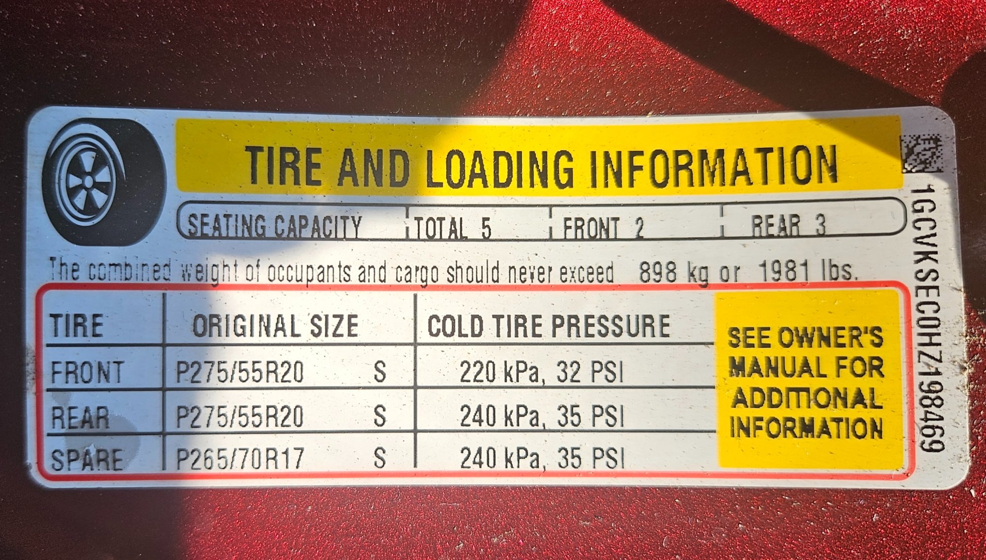

Excuse my stupidity, I have a 2016 High Country with 6.5’ bed.  I want to pick up 1/2 CD wood which might be 1000-1500lb.  Can the truck handle that?
And Google AI says.........
Yes, your truck can technically handle it, but you will be right at or near its maximum limit. A 2016 Chevrolet Silverado 1500 High Country with a 6.5-foot bed has a maximum payload capacity of approximately 1,770 pounds.Weight RealitiesLoad weight: Half a cord of dry hardwood weighs roughly 1,100 to 1,500 pounds depending on the wood type (like oak or hickory).Payload limit: Payload includes the weight of the wood, you, any passengers, and a full tank of gas.The math: If you weigh 200 pounds and have a full tank of gas, a 1,500-pound load of wood puts you right at that 1,770-pound ceiling.Safety TipsCheck the yellow and white sticker on your driver-side door jamb for your truck's exact payload number, as high-end luxury trims with extra features have slightly lower capacities than basic trucks.Expect the rear end to sag noticeably.Drive carefully, avoid sudden turns or stops, and keep speeds low if you have to travel a distance.

    • There are no stickers in your glovebox?
    • Look at the numbers on the stickers in the door jam...
