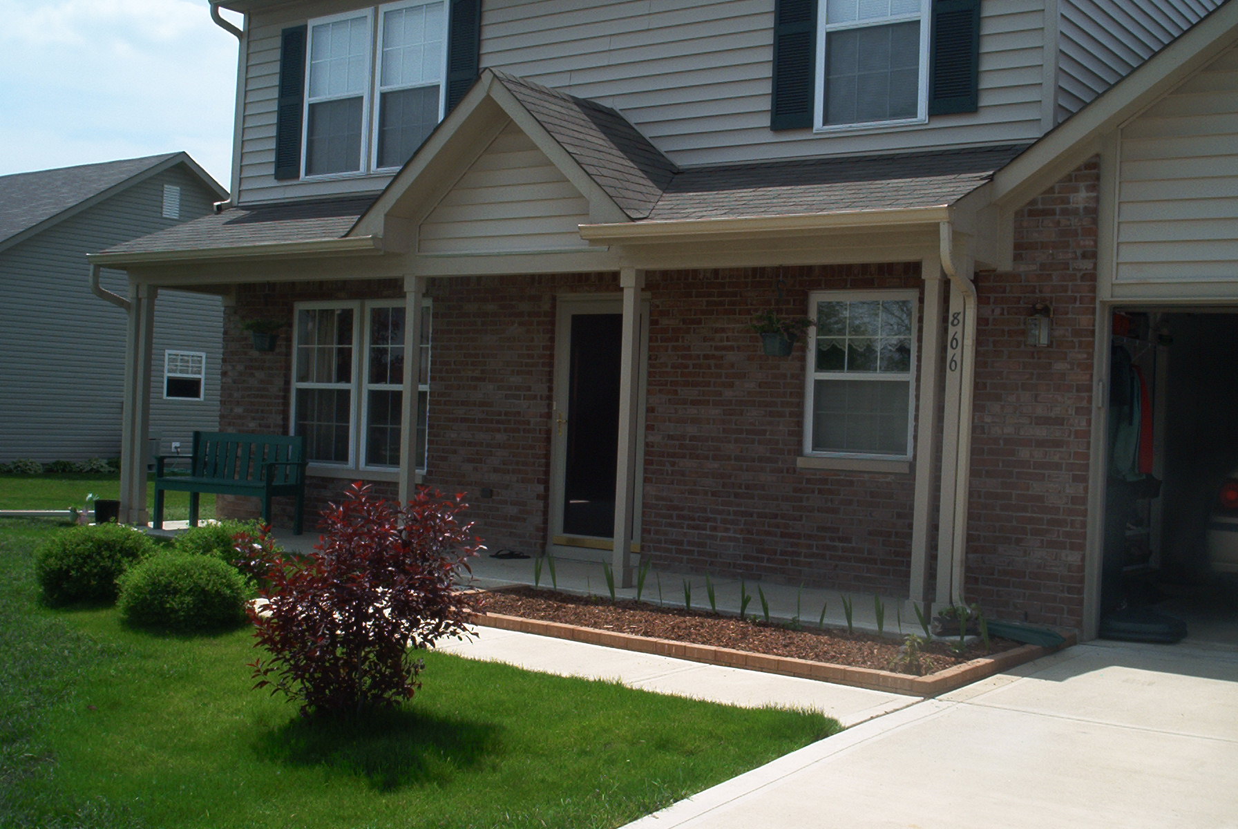

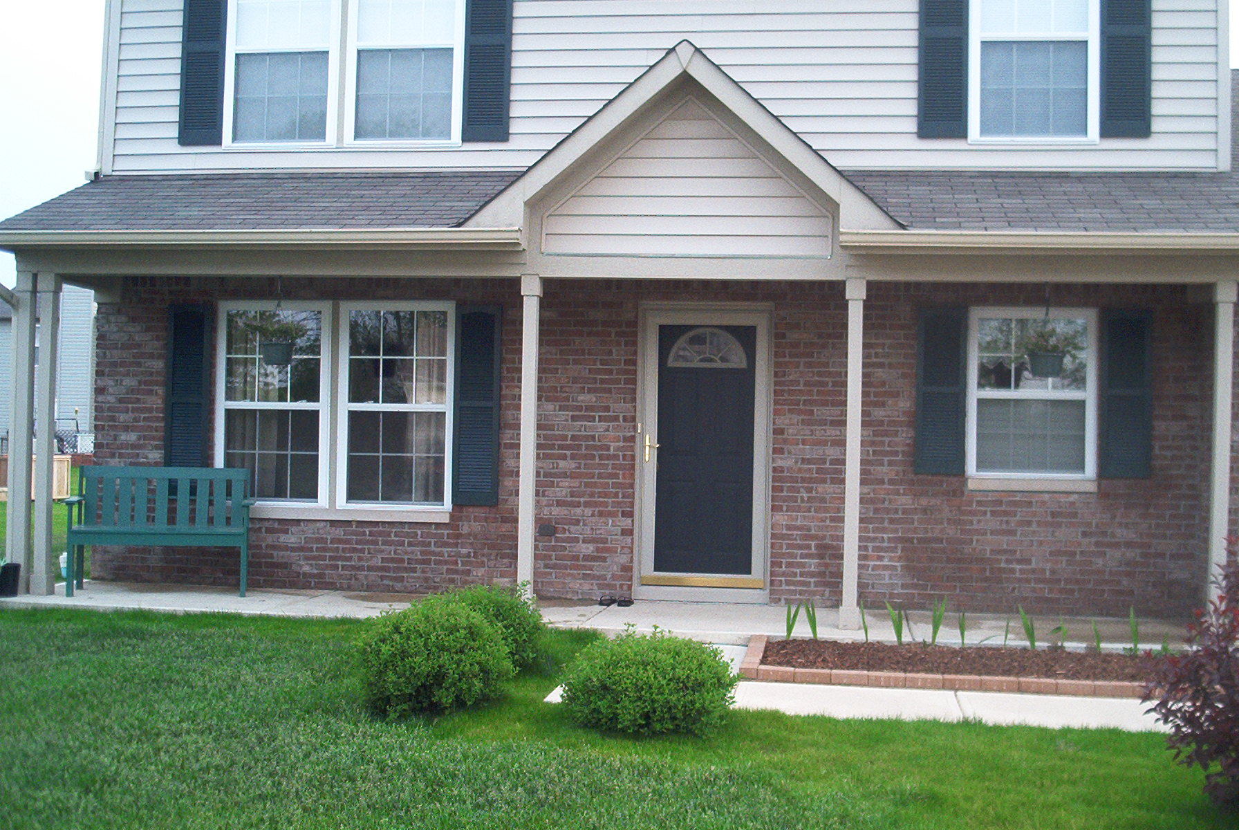

Just thought I would share some pictures of my house
This is before the shutters were put on the main floor windows

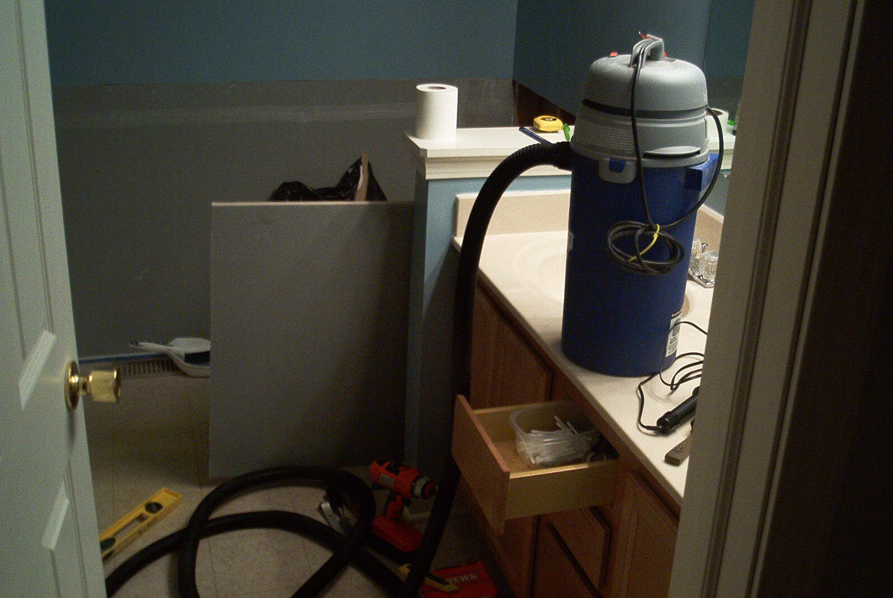

bathroom remodel in progress
Oh man what am I going to do.
Completed: Painted the bathroom blue (was brown/gold), installed new lighting and towel bars, and also new knobs on the tub
1. In the pic if you look straight back you can see grey. The wall around the toilet I removed the drywall and I am installing denshield then I am going to be tiling (6x6).
2. Going to also tile inside above the shower (3 sides 35x35 inches)
3. Install new faucets
Thats all pretty minor remodel

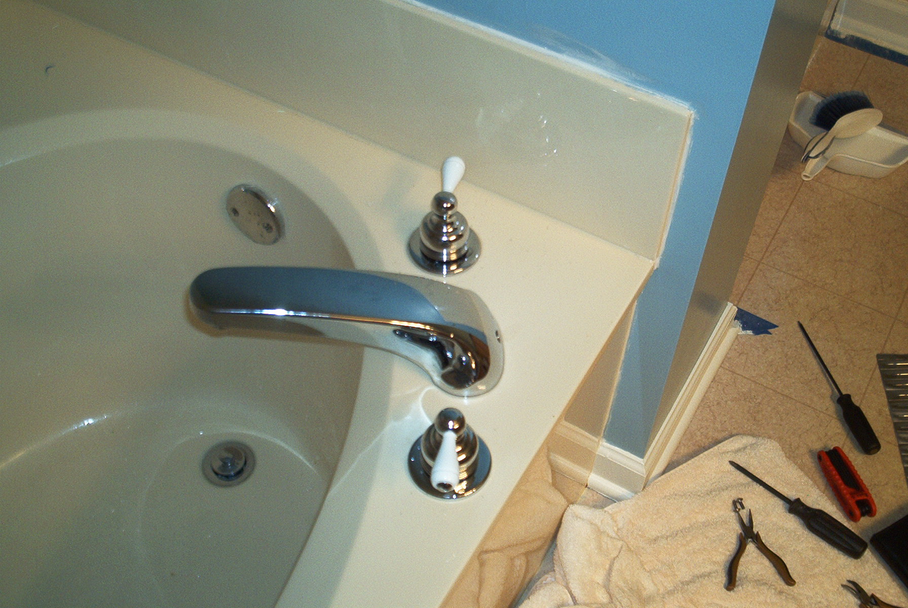

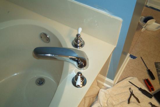

Hey quick question since your a plumber. Its hard to explain (ill attach a pic) but I have a delta tub faucet. The knobs were thise cheap clear ones. Well I bought replacement handles. I installed them (that was an adventure haha) well they wont line up. Where the stem goes into there are 2 small cutouts on the copper pipe where it fits well those need to be moved. Any idea how to do this. See attached pics of how the knobs are uneven

Those hot and cold valves are actually separate pieces so you can loosen the retaining nut on the under side and turn the whole body a little bit either way to make the handles line up, then tighten the nut in that position. If you can't get to the underside you should be able to loosen the trim ring (chrome piece against the tub surface)
The supply lines from the valves to the spout are flex lines or soft copper so they will have some flex to them.
Thats what I was thinking but I havent had time to try. To many projects going on at once. Cant wait until this is all over (probably will never be) and I can enjoy the house. I bought it in January and from then until now it is a totally different house.

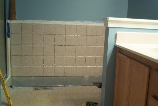

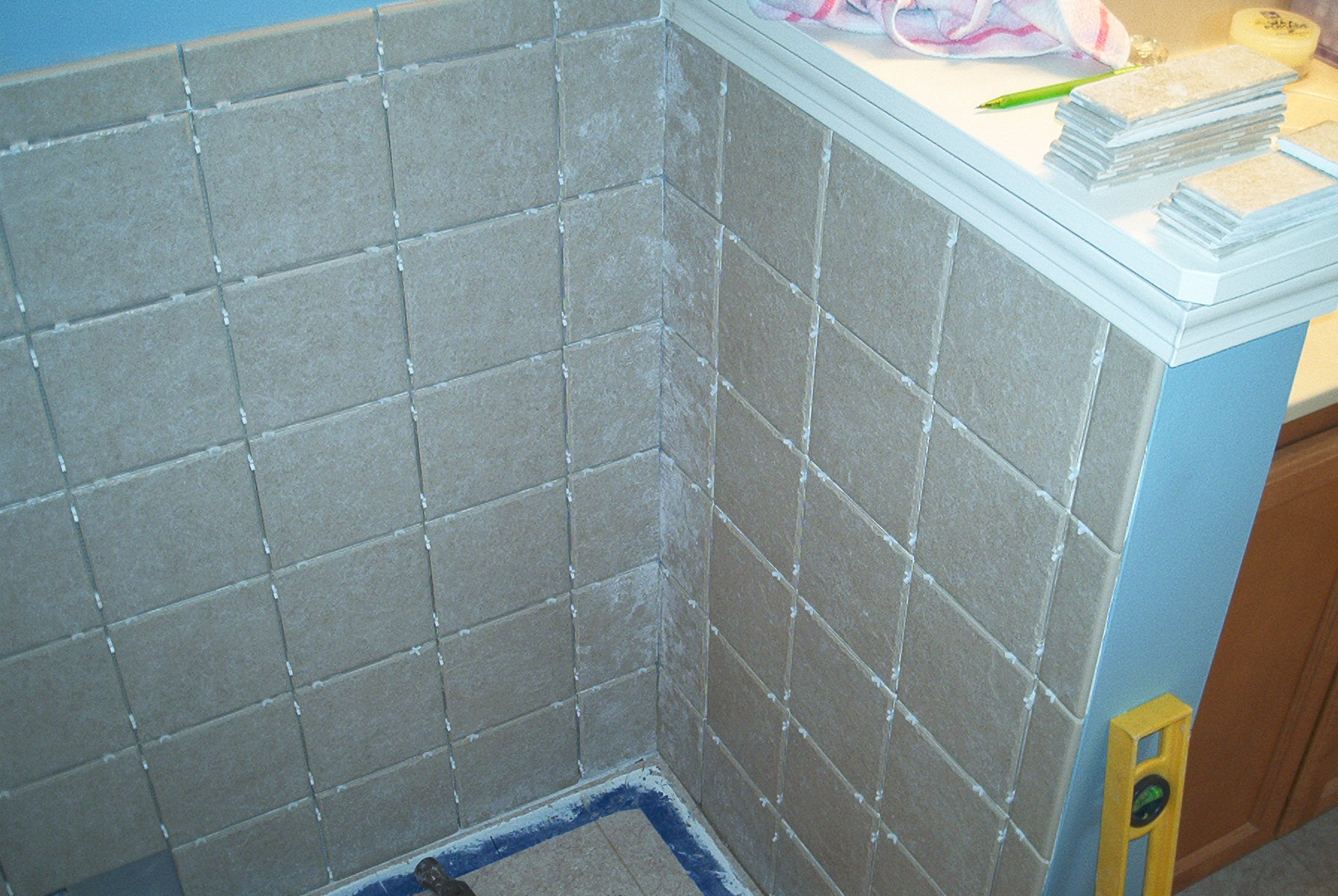

update. Few more tiles to cut and glue. Monday = grout
