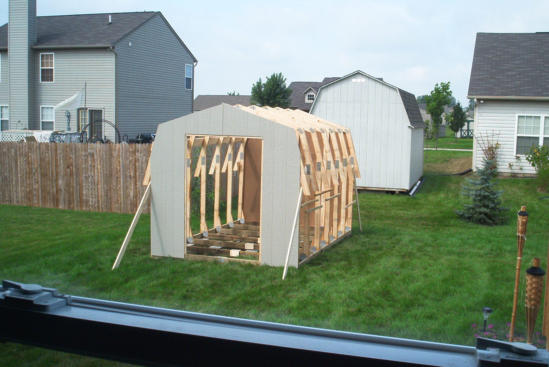

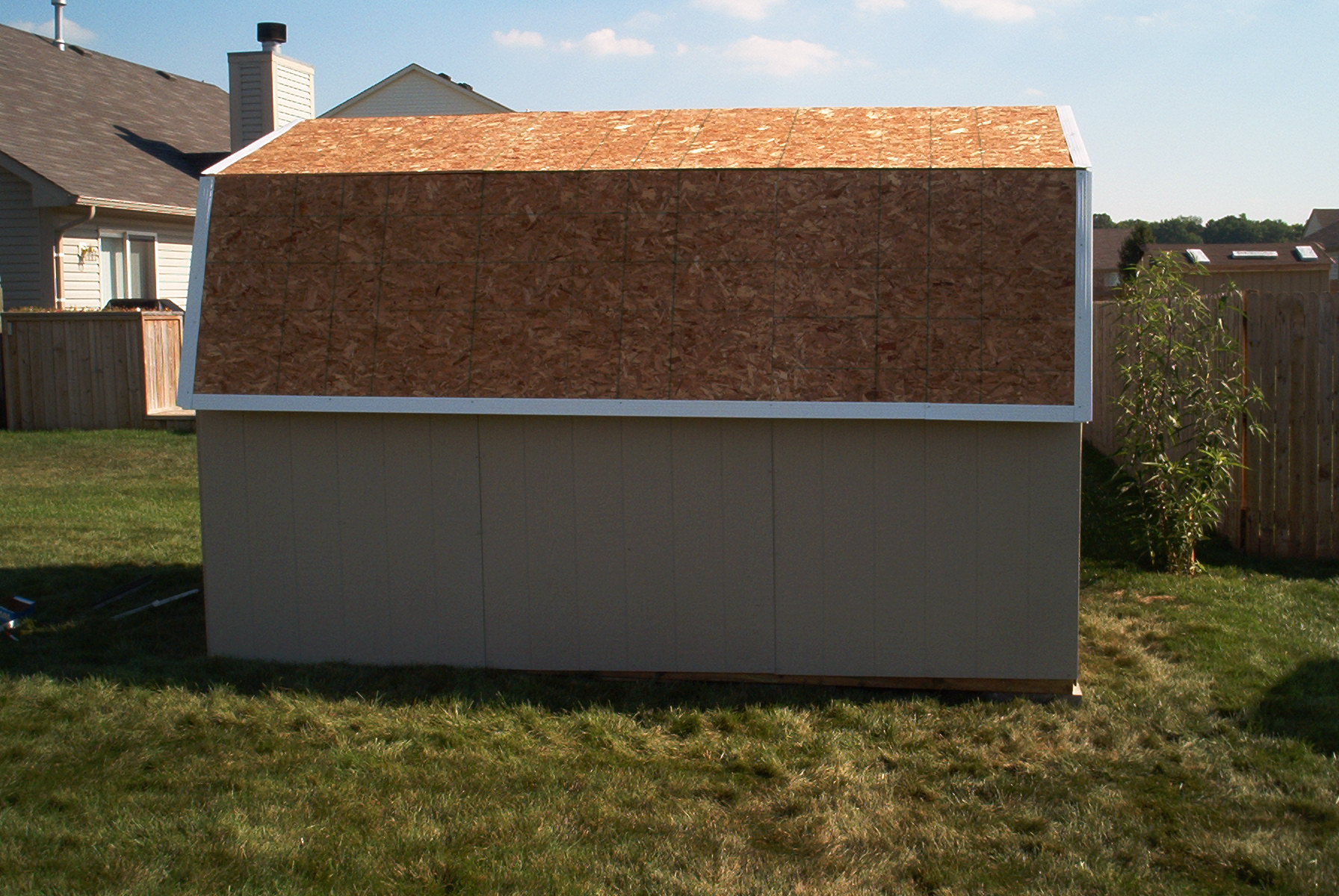

It has begun.
Using 2" and 4" block to level shed. Its going to be an 8x12 gambrel.

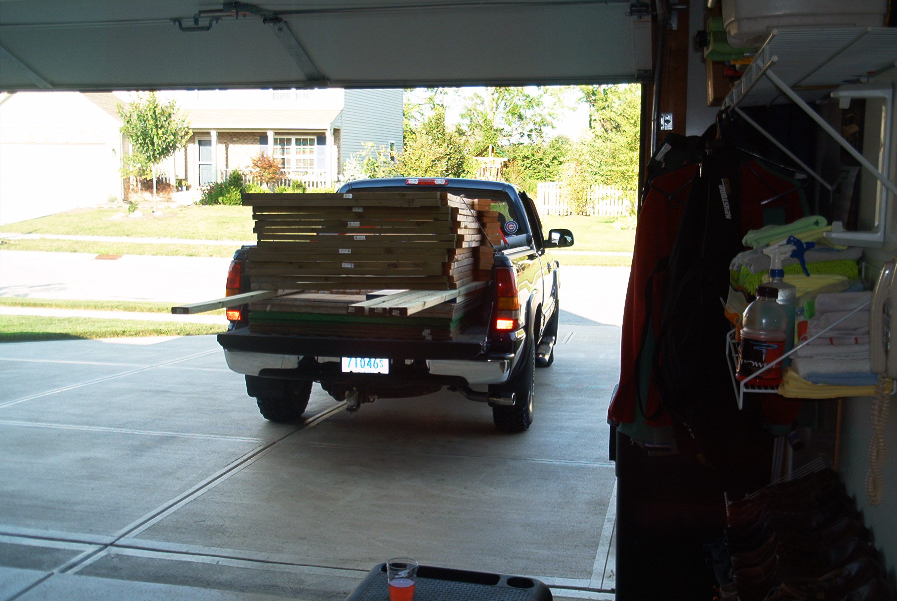

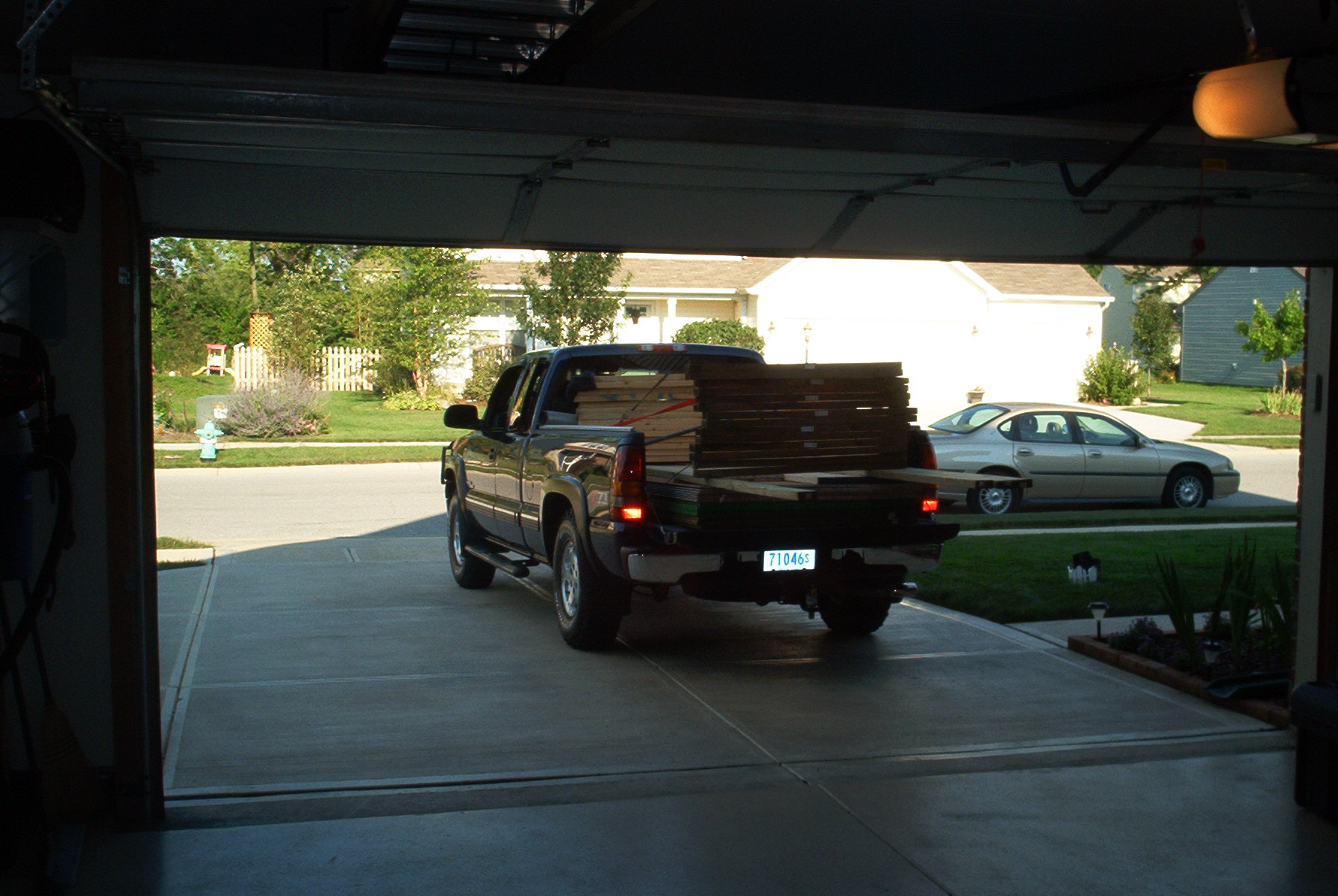

Picked up shingles over the weekend and all the wood and plywood and frames today
Going good so far looks like a shed. Took less than an hr to get the frames up this morning
