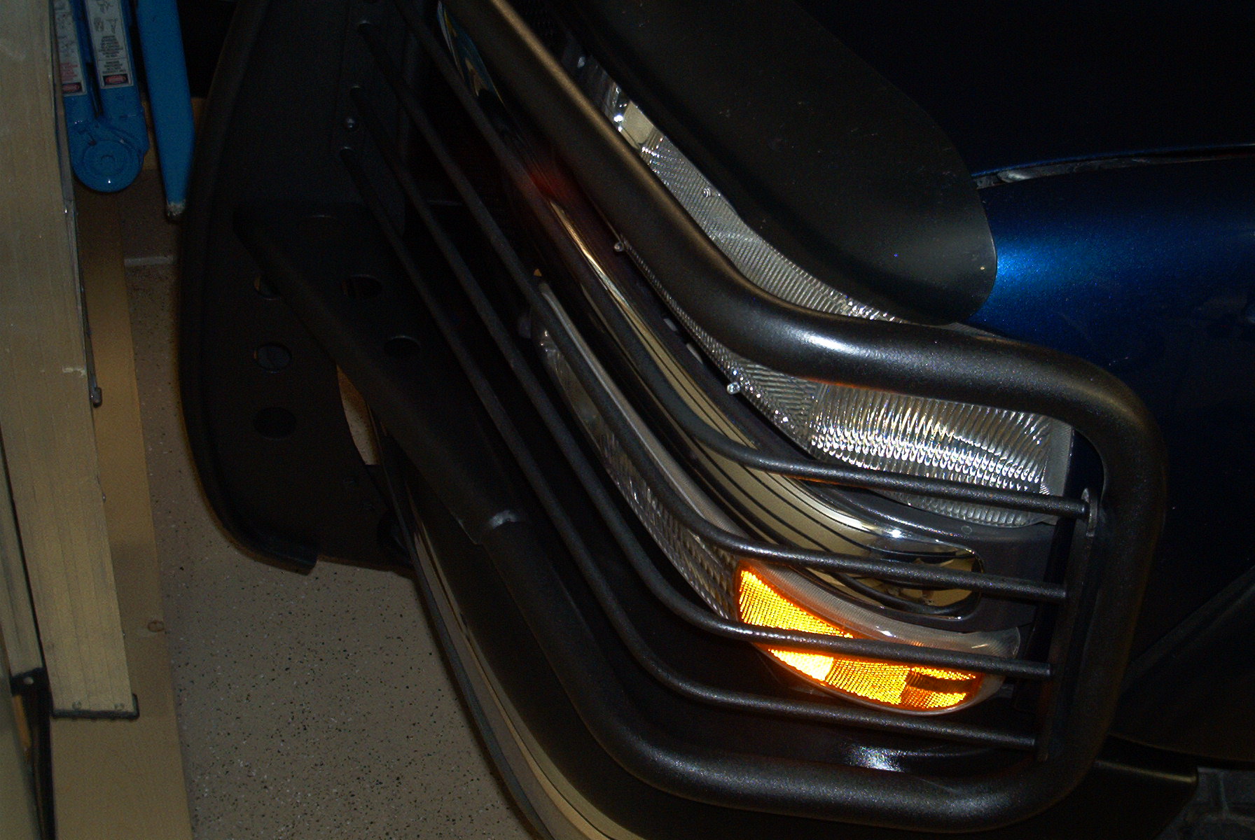

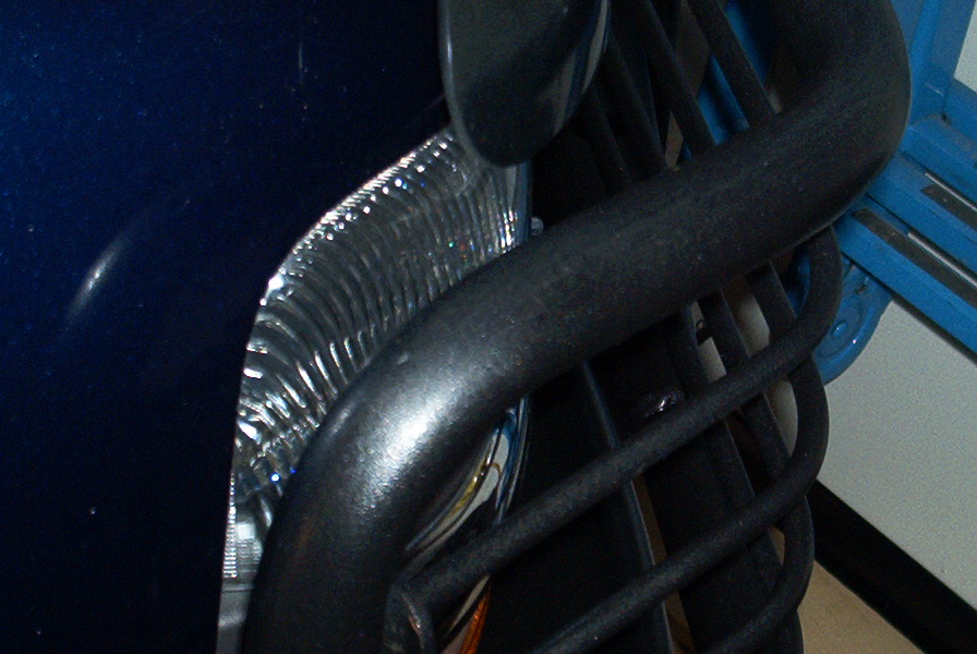

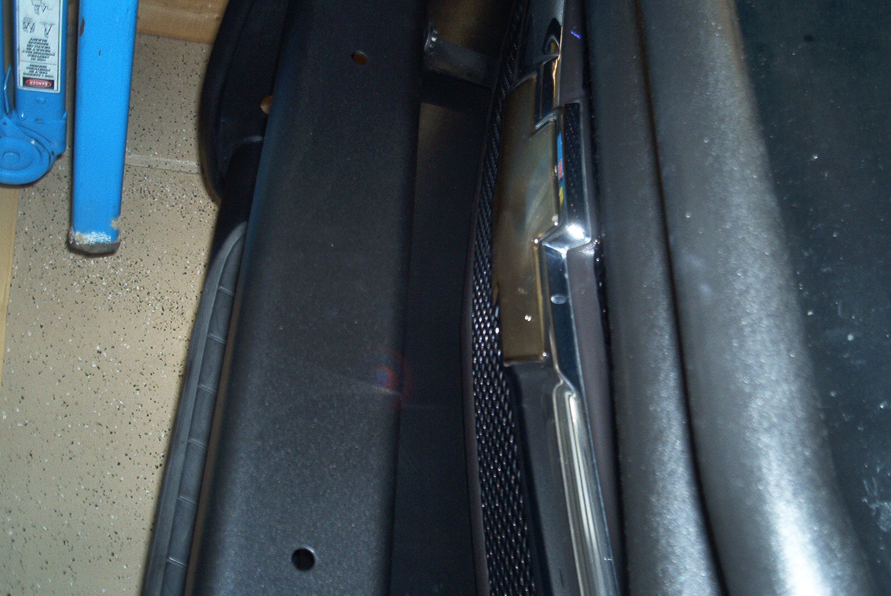

Well my grill guard is 5 yrs old and i looking rough. Took it off last night and with one can sprayed it down. It looks great again. $8 and an almost brand new looking grill guard cant beat it.
Pics to come later
Yes, pictures would be sweet as my guard is definitely in need of some quality time with some paint or spray. What did you do in the way of prep work?
took some of that red metal sandpaper (dont know what grit) just roughed it up. Also removed the step pad with a screw driver. Then put some cardboard and a drop cloth down in the garage and went to work. 1 Can I need just a small spray out of another one 2 minor spots need a lil more I may just rustoleum it for now.
Ill see about pics but its really hard to tell a difference unless you go up and touch it. Its rougher
IMO the Duplicolor undercoating sprays out too thick, I was given a can of some sort when I was in the supply store a couple months back, sprayed out really even and with no mes. Now just to get the name...
Ok got a few
The duplicolor stuff went on smooth no clumps
I did the same thing w/ my grille guard on my old silverado years back. It's a great way to rust proof it.
What I did was went over it with some steel wool to scuff up the surface and touched up some rust spots with some rustoleom and then sprayed away with the spray in bedliner. It gave it a nice shine and texture. I had also sprayed my fender flares too. Turned out really nice. You can see pics on my site in the silverado section.
