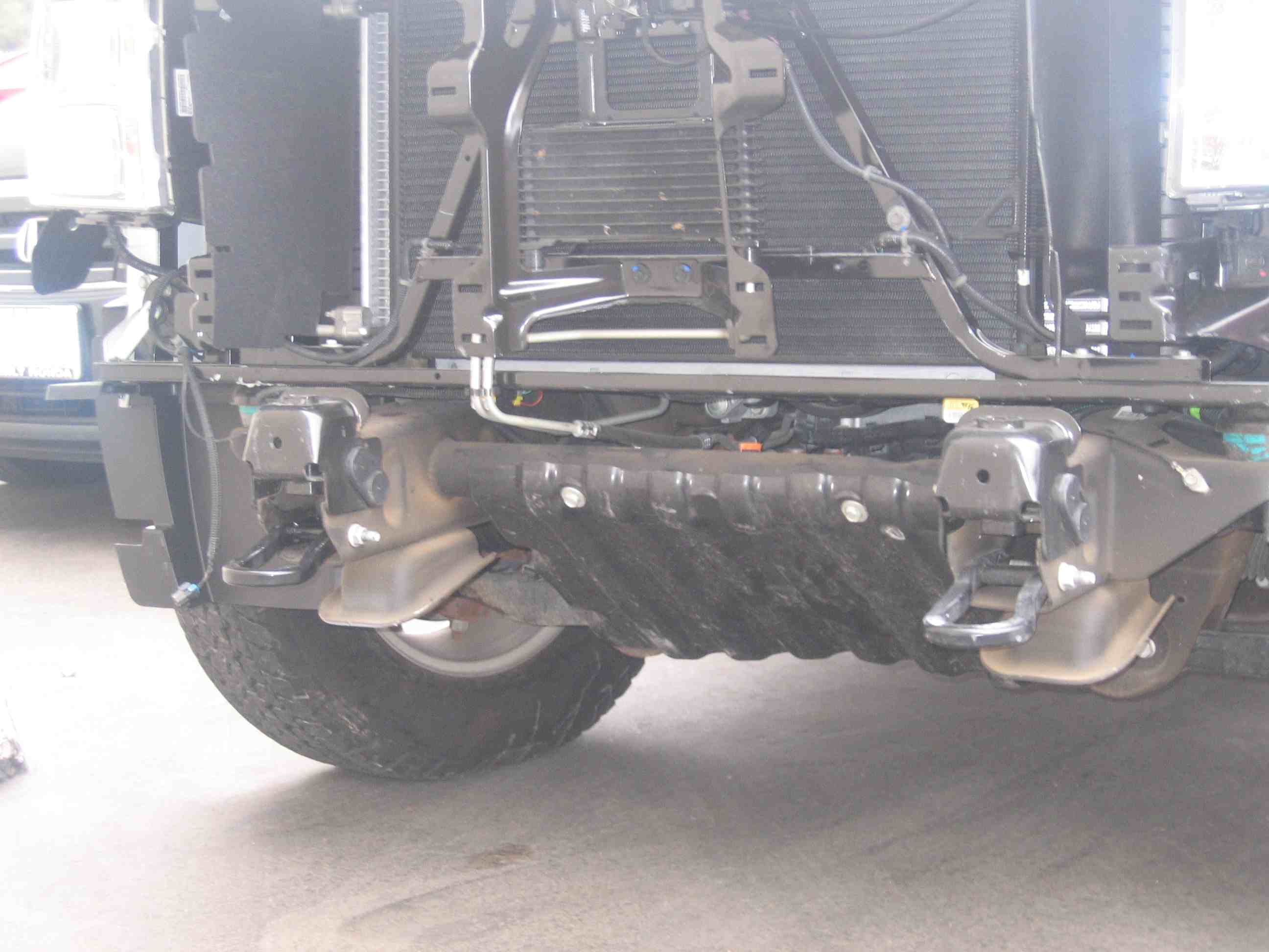

Here is a good shot of what the loops look like behind the bumper on my NBS Sierra. They look very sturdy to me. post-23345-1196286494_thumb.jpg

Seeing that the NBS's don't have "hooks" but more like a "shackle" or "loop" here's what I would do....
The tow straps are available with loop ends. Take one end and put it through the tow loop under the bumper then take the other end and feed it through the loop that you just put through the tow loop.....make sense?
I would actually think that if you got a good quality shackle that's rated with a very high strength then you should be ok to use that to attach a strap to the front tow loop.
