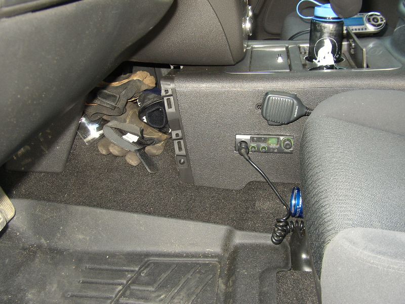

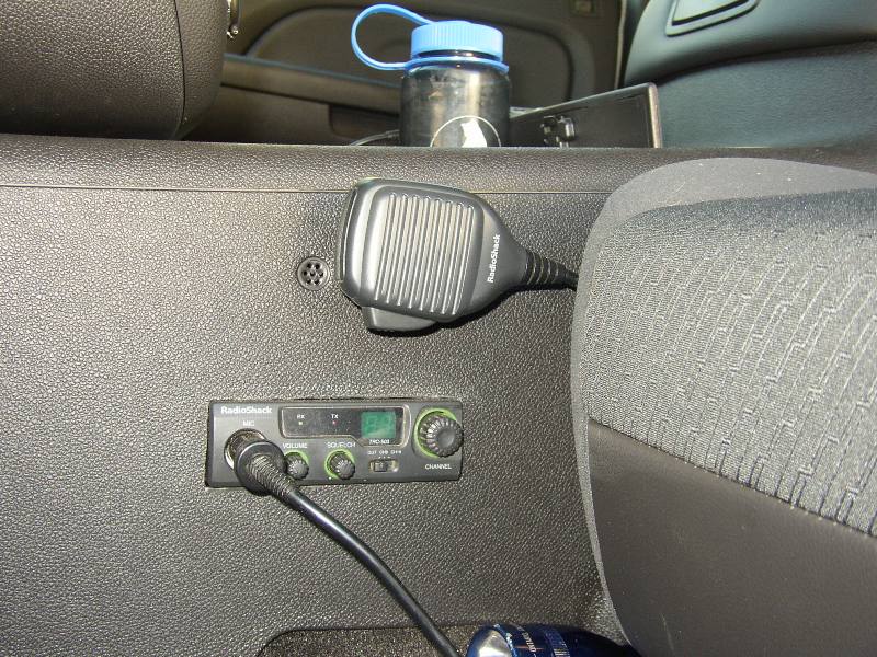

Here of some pics of the CB mounted in the center console. They aren't the best, but you get the idea. Under the cup holders there is a hard plastic bracket that I mounted the radio to, and then just cut the hole in the plastic. The power comes from the aux. 12v to the back seat, and then I just ran the antenna wire under the carpet, out the extended cab door, up the window molding and to the roof.
And I found that if i kept that cover off next to the gas pedal, its a nice storage place for gloves.
Don't mind the dust...I am on a red clay construction site all day and when its dry... holy...---ing dusty!! I can never keep it clean.
That looks like it came out pretty good! Congrats on the clean install!
Thanks!
I had to cut it out with a razor blade. I would like to find a trim piece to go around, but I have no idea what I would use.
Thanks!
Depend on the dimension you might be able to use the face plate trim of a CD-ROM drive
Thanks!
You could run some rubber foam type gasket along the edges.
I've been debating where to mount one in mine. When I read center console, I was thinking down "in" it, so that it was easier to conceal. I've seen a few video game systems mounted down in the center console on the SD's. I'm sure a CB could easily be mounted, wired, and concealed in there..
Nice job, by the way! :rollin:
