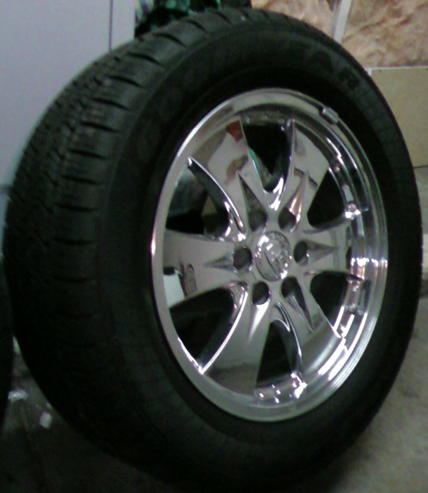

Hello All,
I have some 20'' GM Performance Accessory Wheels from my 2005 Silverado.They are
20X8.5 with 22mm offset. Im debating on putting them on my 2008. I know they will
bolt up but is there a difference in the newer GM Accessory wheels as far as offset?
Also, are the lugs the same threads between the 800 and 900? I know the chrome
steel wheels are the same for the 2005-07 800 and 900 but I just wanted the experts to
weigh in. Thanks!
Every wheel has different offset, as long as it's 6 lug and at least 4.5" of backspace it'll fit...
IIRC the 08 wheels have an offset of 31, so wheels with a 22 offset should be okay.
Here is a wheel offset calculator to compare the wheel offsets. Wheel Offsets
The OEM GMT800 wheels have a different offset than the OME GMT900 wheels but it isn't a big difference. When going from one vehicle to another, I'd recommend test fitting to make sure you have proper brake component clearance and the center bore is correct. Lugs should interchange.
