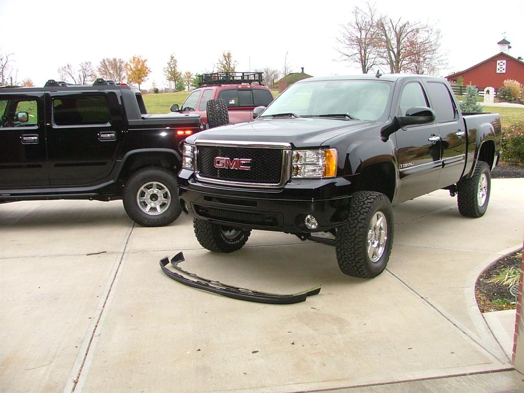

38's on the 1/2 ton drive train is going to cause problems for sure. You might physically get a tire like that to fit, but the front wheel bearings, rear axle shafts, and diff, front axles and other things will not stand up to the added forces of such a tire. Your H2 was actually a 2500 HD truck with MUCH beefier parts which easily accomodates 37's. Even so, the H2 would break front axles and tie rods with taller tires.
I own both a H2 SUT (lifted) and a Sierra Denali (lifted). The Sierra is no where near the H2 as far as strong, heavy duty parts are concerned. On my Denali, I have a 6" Superlift and only 33" tires and it all works fine. I think you might want to lower the bar a tad bit and consider a more reasonable (and less costly) tire such as the 33 or perhaps a 35, but no larger.
Also, unless you have a Denali or a Vortec-Max, you don't have much horsepower, and I believe the power loss from a 37"-38" tire would be very noticable with out a gear change to 4.56 or 4.88. Here's a pic of the smaller tire on the GMT-900 with a 33" street friendly tire

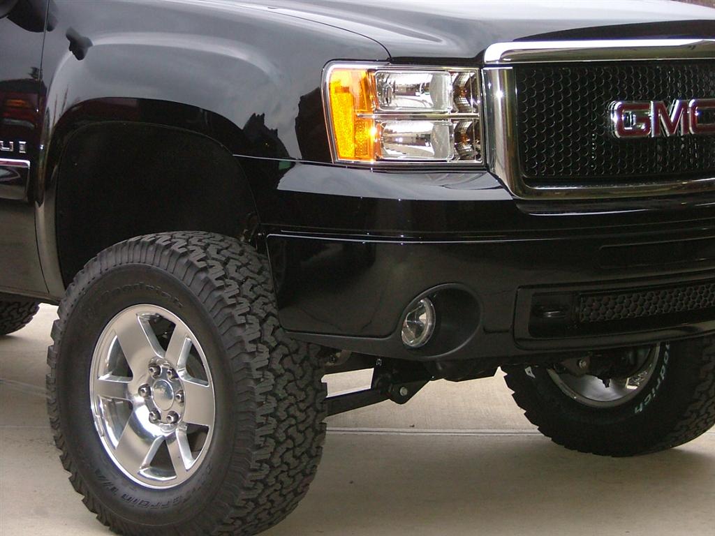

You know, since mine has the stock wheel with something like 5.5" B.S. and the tires just fit inside the wheel well, those wheels are either 5" or 4.5" back spacing (I think)
I went with a 5" backspacing. Keep in mind that all these lifts increase the front track width.

I'd keep the H2 (I did) for off road. It's W A Y better than the truck for that. Remember the 1/2 ton truck drive train is no where near the strength of the Hummer. Also the lifted 1/2 ton turning radius and sheer length will not allow it to be very good at anything difficult off-road. So do the H2 and...
Lift the Silvy or Sierra and drive on the street or use for mild trail work.
