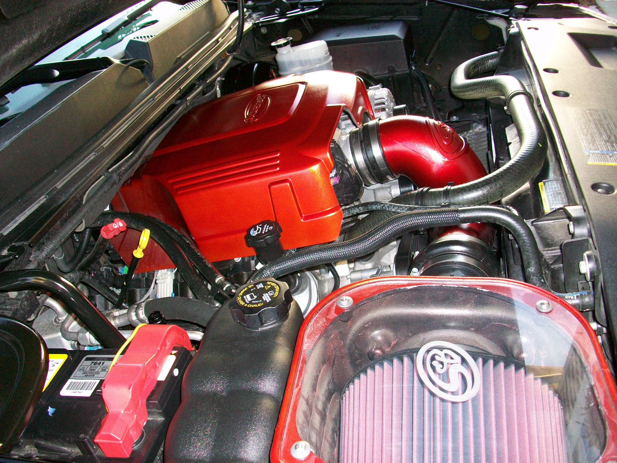

I have the S&B Intake. (I painted it before I installed it along with the engine cover). I had one on my 2004 Dodge Ram cummins also. Great fit, finish, and quality.
