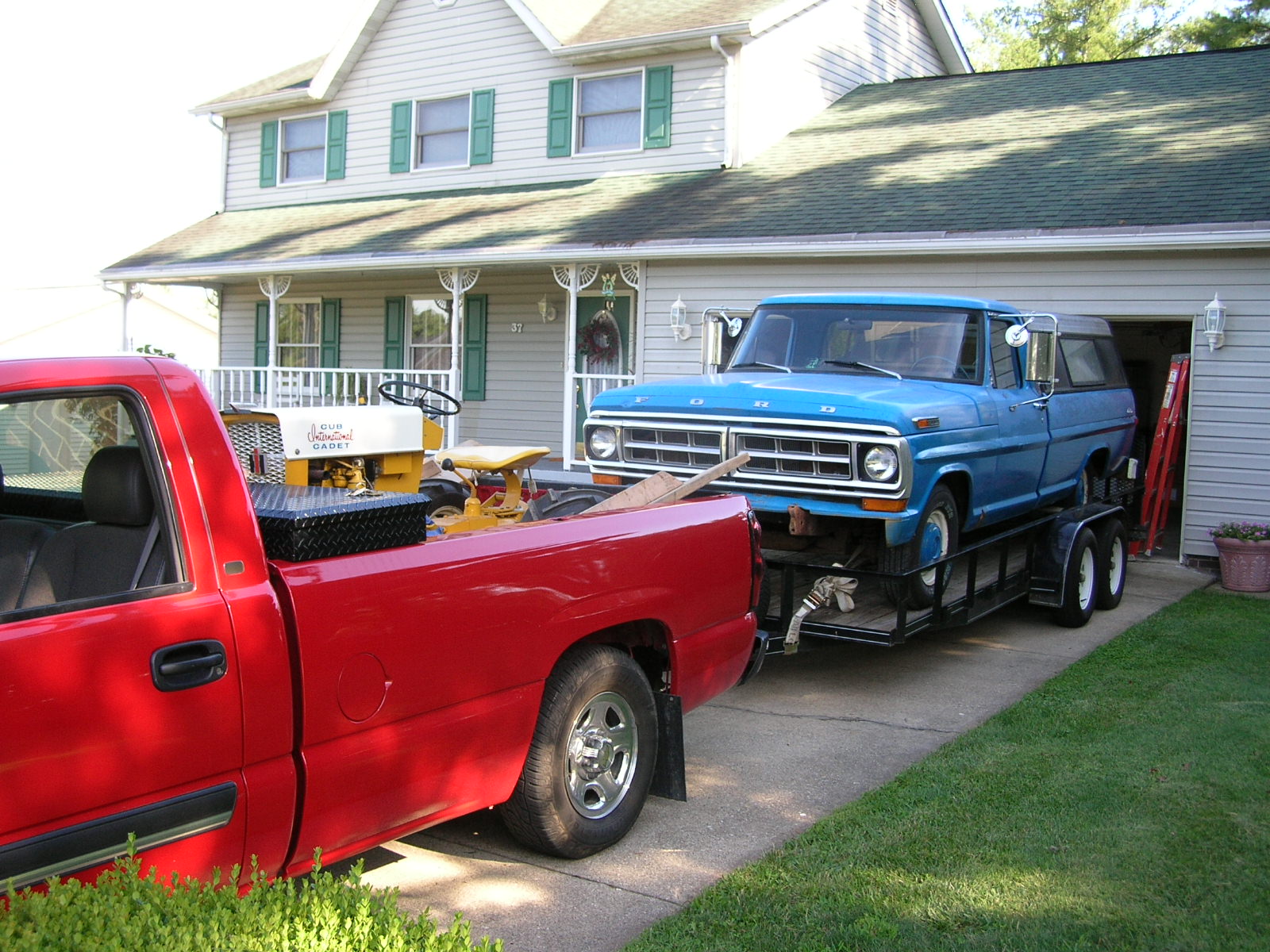

I used my 04 1500, 4.8, 2wd, to fetch my 71 F-100 from my wife's granddads place in Halifax, VA.
Right up over the mountains of Virginia and up through WV on 77.
The U-Haul trailer had surge brakes that made the difference. The truck pulled very well for what it was.
Stopping was not a problem at all.
Then....... Same truck, my trailer, moving to PA so I put waaaay too much stuff in the bed of the Ford, put an old cap on it to keep it dry and then ad a Cub Cadet to the bed of the truck.
A little over weight, maybe.
My trailer has electric brakes.
More of moving my stuff north.
