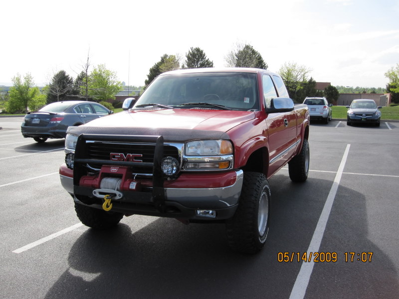

Type Of Line On Winch?
I recently purchased a 2000 GMC Sierra SLE. It has a Warn winch on it with rope and a hook, not cable. I am not that familiar with winches. It is ok to have rope instead of cable? I have no idea what kind of line it came with, but my thinking is with the rope being exposed to the elements, such as rain and snow, the rope would weaken. With my lcuk, I'd actually need to use it and the rope would break because it had been exposed to the elements.
I've attached a picture of the truck for reference.
Let me know your thoughts and thanks in advance! :dunno:

Thanks for the fast reply. I appreciate your research and feedback. This is a 9500 lb winch (I believe). I feel better seeing "Warn synthetic rope" and not thinking it was just something the previous owner threw on there. The hook and eyelet look professional so I thought it was probably for that winch, but I wanted some feedback from others to make sure.

You have a Hawse fairlead on there. The other option would be a Roller fairlead (which has 4 rollers by the name sake). I also looked up the synthetic rope and it seems to have a much higher strength than steel cable, plus added benefits of not kinking, fraying and such.
