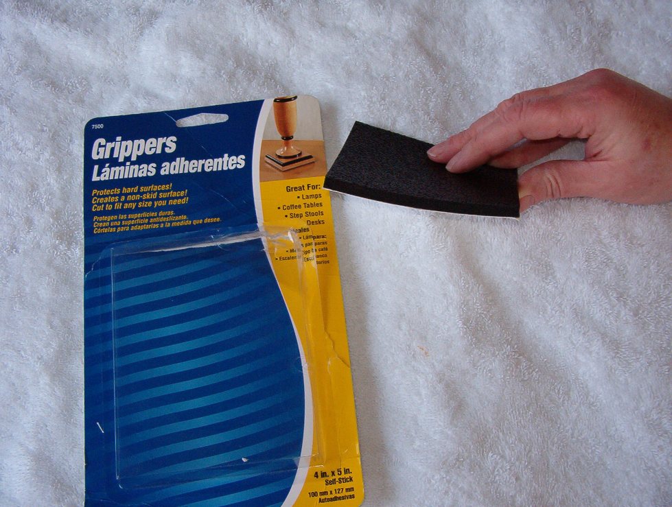

It was the door panels front and back on the right side. On the rear door at the most aft upper corner of the door panel where it comes to a point it was rubbing against the painted surface.
On the front door it was the same type of issue, but at the upper front corner of the panel.
I went to Lowe's and bought some stuff called "Grippers" it's used to keep sofa's and such from sliding on wood floors. I bought the 4" X 5" Self-stick. It's about a 1/4" thick. I cut 2 small pieces, pulled out on the door panel corners with my fingers, and pushed that stuff in there without removing the backing. (I didn't want it to stick to the door so I could change it someday if it gets old).

OK...I hope this comes out....Sorry the door pic's are a little fuzzy....It's cold out there....And my wife was laughing because I wanted her to point at the stuff ...Long story.
First pic: is the padding stuff to buy at Lowe's.
Second pic: is what the padding looks like out of the box.
Third pic: is the R/H rear door with the piece of padding in place. It's that little thing with the white backing on it.
Forth pic: is the front R/H door top forward corner of the panel.
I hope this helps...... :flag:
