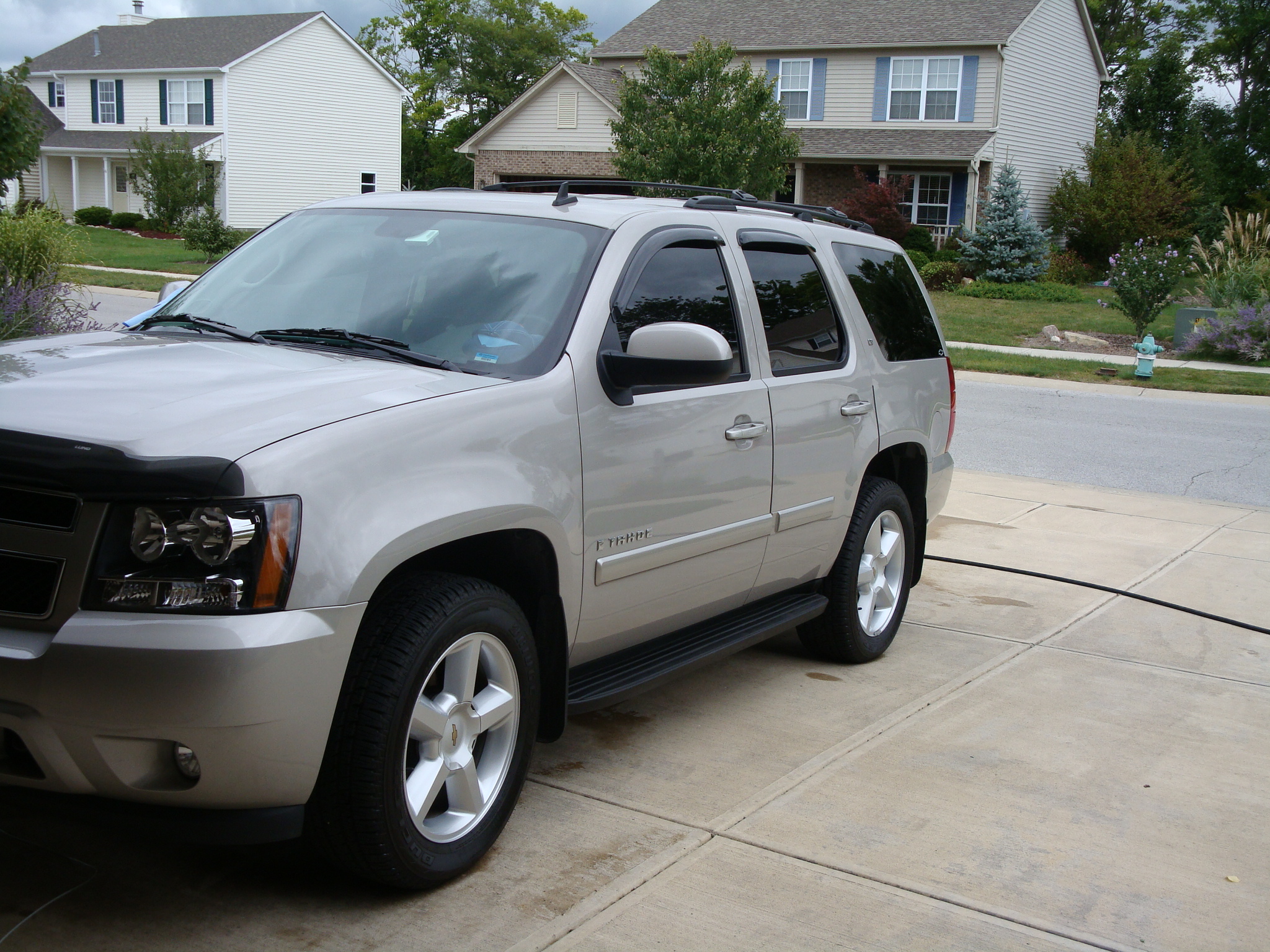

probably similar to the tahoe boards see photo
I like them except if you put any kind of coating (303, back to black, etc) to clean them it makes them like an ice skating rink. I along with others have slipped off them. At least the pass side has a grab handle
Yeah, I was afraid they'd get slick with anything I put on them. I guess my wife better be careful, she's the one who said we needed them as I can get in and out just fine! I like the look of them on the SUV's better than any nerf bar or aftermarket board I've seen on the trucks, but everyone keeps tellng me they won't work. They can't tell me why, or what is different, just that it won't work. Either way, I'm only out the $75.00 + shipping that it cost to order a set of take off boards from eBay, which are supposedly brand new with no miles on them. The seller says they came off an 08 Suburban and he had ten sets so it must have been a business that bought a bunch of burbs' but didn't want boards on them.
