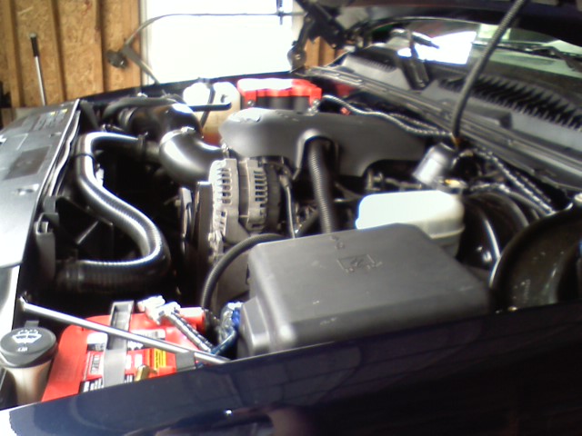

post-68170-1259341471_thumb.jpg post-68170-1259341757_thumb.jpg Installed dual optima red top batteries on my 06 GMC sierra 1/2 ton. now have over 2000 cranking amps!! just have to finish strapping the cables across the fire wall.
did you have to wire it up any special way? or just connect them to each other?

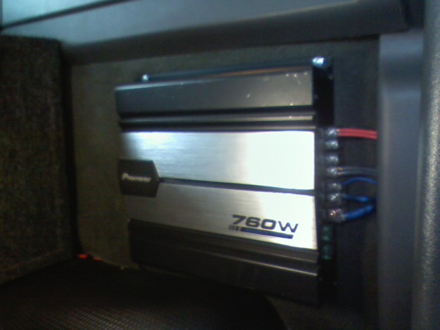

i just connected them to each other, positive to positive, neg. to neg., i used #2 welding cable that i purchased from a local welding supply store, its more flexible to work with and better under load than standard THHN wire. and yes it does power a nice size amp and a sub, i have a pic of the amp i mounted behind the drivers seat on the back wall of the cab. my whole reason for goin with dual batterys was because i was killing an optima battery just about every year from the constant abuse. good thing the optima batterys come with a 3 year warranty i guess :fume: def. got my moneys worth. there isnt anything as far as speakers and audio that i havent replaced, i even upgraded all the wires going from head unit to the speakers to shielded #14 wire to reduce any ground noise going to the speakers :thumbs:

i thought about it, but i really have no need for isolating them, if you were running power for a camper off a inverter with the engine off then i could see a need for isolating them cuz if you run one batt. down then you could start the truck with the other battery. even when i had just one optima battery iv never killed the battery to the point were i couldnt start my truck, last winter i was working outside all day putting pole lights together on a job we were doin so i had my stereo on most of the day while i was working and i came really close to needing a jump, i was playing music with a subwoofer on for at least 5 hrs straight, tried starting my truck wouldnt start, then i saw i still had the heater on, turned it off and the truck started right up still to my surprise. you may also want to isolate if your using your truck plow alot because that could also kill your battery and you dont want to be stuck knocking on a customers door for a jump. if your not using an isolator i would def. recommend making sure both batteries are the same though.
