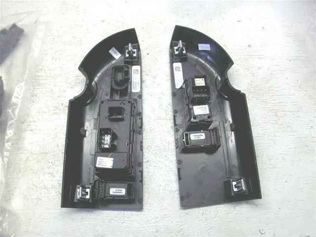

For identification purposes, this is the hardwired style of switch:
And this is the style with the databus module (note the different types of connections):post-68159-1263218960_thumb.jpgpost-68159-1263218966_thumb.jpg
From what I've read, you can identify the databus style without seeing the connections by that larger circle mirror adjustment pad and the half-circle notched mirror selector button under it, versus the smaller mirror adjustment pad and rocker-style selector switch on the hardwired style. But if you want to double-check (which I did just in case I was lucky enough that mine were somehow the databus style even though they look like the hardwired ones), it only takes a minute to disassemble the door enough to remove the switch and see what type of connectors you have.
